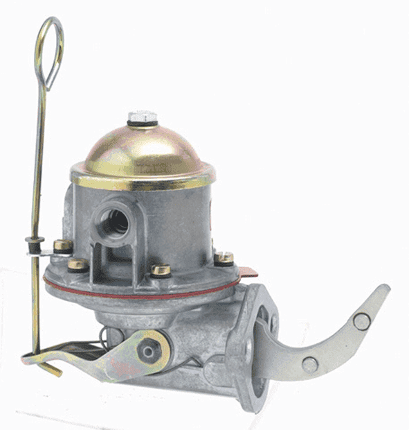

I'm trying to come up with a design for a handheld pump that will be used to suck diesel from a car's fuel tank. There's definitely going to be a pipe dipping into the fuel tank, and there's definitely going to be a human manually operating the pump.
I'm trying to think of a mechanism that would transform rotary action input, (like a rotatable lever) into suction force that would pull the diesel in the fuel tank into the pipe. But I can't think of anything lol. The main problem is I don't understand what kind of motion is needed to provide a suction force through the pipe so right now I am just thinking through mechanism elements like shafts, cams and gears with no end goal in sight
Any ideas? TYSM

The application you described is called a diesel lift pump. There are may designs, some mechanical, some electrical. You can almost visualize how it converts rotary motion into reciprocal motion in the picture below. It has a lever attached to a wire used to manually operate the pump. That is used to purge air from the pipes before cranking the engine.

Priming the pump will be the difficult part, because gear and vane pumps may bleed too much air through the sliding clearances, or shaft seals. The easiest rotary hand pump to make yourself would probably be a peristaltic pump using a single long silicone or rubber tube that starts in the tank, pumps, and delivers the fuel to its destination.
