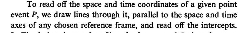

r
Why do we draw parallel to the axes?
What does ensure that reading off the intercepts this way gives the space and time coordinates?

Pushoam said:
View attachment 205378r
This is the definition of those coordinates.
This is the same thing we do with an ordinary x-y position graph. Are you asking why an x-t (spacetime) graph works the same way, or are you asking why all graphs work this way?
A line parallel to the x-axis is a line of constant t.
A line parallel to the t-axis is a line of constant x.
If a line parallel to the x-axis is a line of constant t, then that line passes through the t-axis at the value of t where x is zero.
If a line parallel to the t-axis is a line of constant x, then that line passes through the x-axis at the value of x when t is zero.
As the others have pointed out, this is the way we define things when we create graphs. It's what they mean, by definition. These points on the axes are called intercepts.
