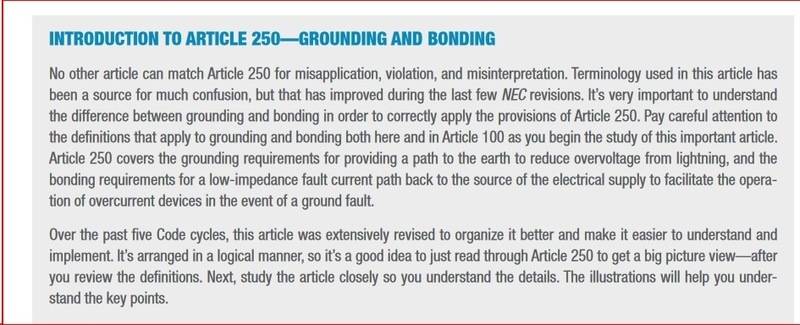

as i said there's a lot of confusion stateside.
http://www.mikeholt.com/instructor2/img/product/pdf/1292432628sample.pdf

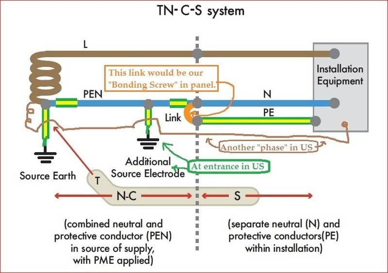

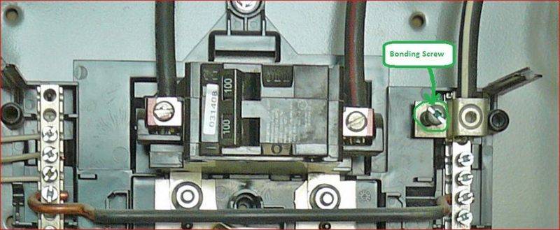

just to clatrify, though i'll probably only muddy it further...
Here in US that's only permitted between the main premises entrance and the utility's transformer.
Inside the premises, with our present day code, they are separate paths joined together at a single point, where power enters the premises, as in that photo in post # 24

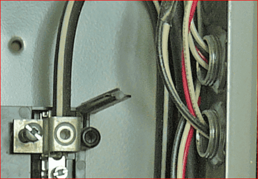

Because this photo is a sub-panel the green bonding screw is not engaged . That keeps neutral separate from ground at this location. They're joined only where power enters the premises and that's called "Bonding".
White striped neutral wire is the return path for load current,
Fault current returns through the metal conduit and metal of the electrical system to the main panel, where neutral IS bonded to the metal.
If no metal conduit then there's a return wire in each branch circuit for fault current that's either green or bare. My panels have another terminal strip for them that is spot-welded to the metal box. I ran a fault current return wire (four conductors total) to my guest house panel to join(bond) the metal parts together because i'd buried plastic conduit to it not metal.
Were this the service entrance adjacent meter box, the white striped wire would go out to the transformer neutral and that green screw would be engaged so as to give fault current an all metal path back to transformer neutral via that utility side neutral conductor. That all metal path parallels Earth assuring a hard fault will pass enough current to trip a breaker, and that a mild fault won't raise Earth potential out there at the fault by very much.
That's the only part of the path where load and fault current share a conductor, incoming(utility) side of main panel..
I won't be surprised if US code calls for a separate wire for fault current return on utility side of the main panel in the near future.

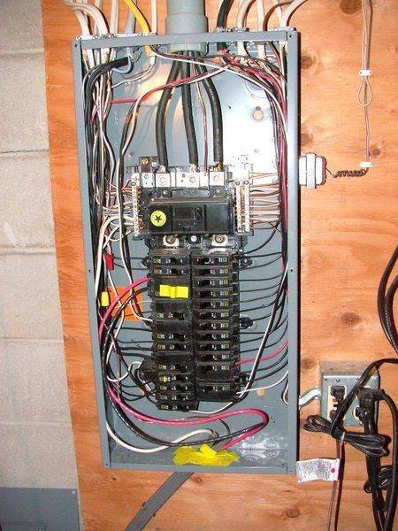

Here is a typical example of a service panel in the USA. There are 3 large conductors going into the top of the panel. Two hot wires, one each on the outside and the neutral in the middle. 240 volts between the hots and 120 volts between the neutral and either hot. Notice the smaller copper wire that connects to the same place the neutral connects. There are other heavy copper wires on the neutral bus as well. The neutral bus is on each side with many white wires and some bare copper wires. One of these heavy bare wires is the one that goes to the water pipe. If you have an all metal plumbing system to the street and your neighbor does too, you can cut the large neutral wire in the center and now all of your neutral current goes through the smaller copper wire out through the plumbing system. Normal current, fault current, doesn't matter. It's all going the same place.

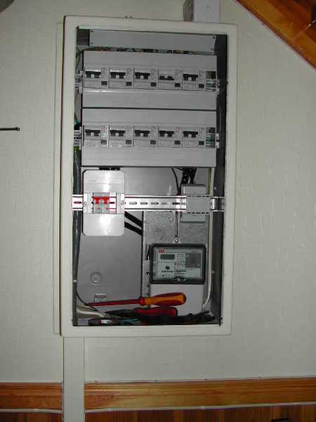

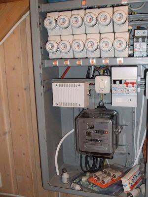

Anecdote: When my new house was finished (early 2011), a guy from the power distribution company came to check the wiring. He took one reading in the fuse cabinet and exclaimed: "There is a serious ground fault here! But it is outside the house!" He reported it back and they did something about it - 11 months later. So a ground fault - almost a short circuit to "Earth" - turned out to be a minor irritation.
As to the service panel above: No way such a panel would be approved in Norway. Here is a picture of an old-fashioned service panel that will not be approved anymore.
umb_643835_faste-installasjoner-kontakter-lamper-etc_stoerre-arbeid-hovedtavle-sikringsskap-osv-.jpg
Here is a picture of a modern service panel:
