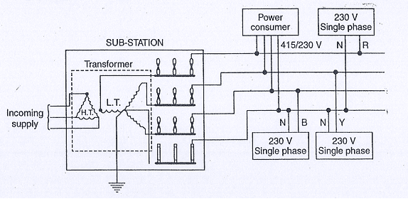

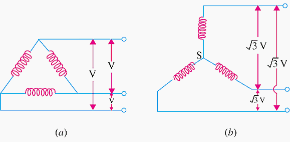

A fuller explanation is in http://electrical-engineering-portal.com/phases-and-wires-in-distribution-of-ac-power, but I will just copy one figure:
The delta connection in (a) has no ground reference and there is no "neutral". If the ground connection is poor (as it usually is in Norway) the voltage between "ground" and the phases may literally be anything. The concept "protective ground" relates to the fact that water distribution used to be buried copper piping and as such had a fairly good connection to the "ground". Thus, any leakage in the power system could give you a nasty shock if you touched a faucet or something else connected to the water distribution in the house. Thus the "protective ground" - introduced in order to ensure that leakage current was directed to the same "ground" as the water system.

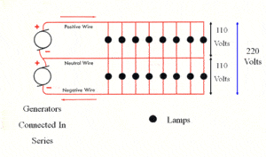

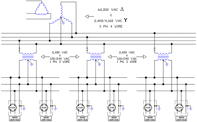

The US uses 'split-phase' center tap 240vac to residential 'lighting' circuits. (an historical holdover from Edison three wire DC lighting circuits)
http://ethw.org/Early_Electrification_of_Buffalo

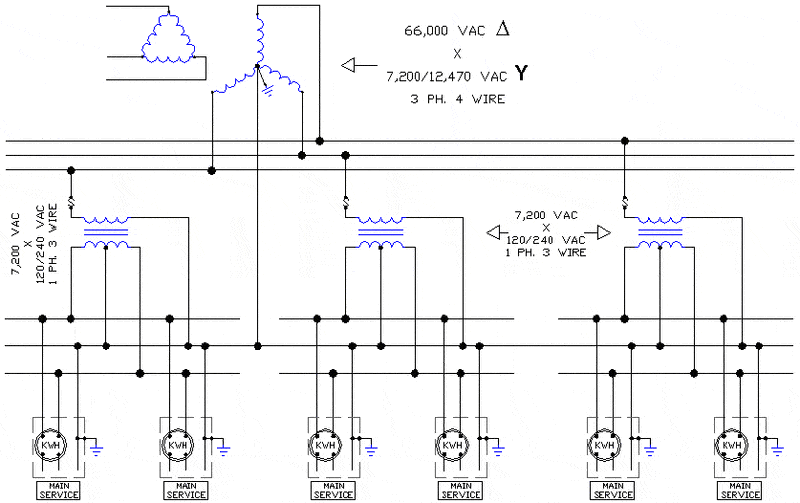

A few typical types of US power feeds with grounds and neutrals.
In all cases the standard 'split-phase' connection to the house remains the same.

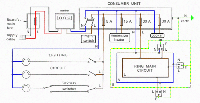

It's my understanding that UK residential 'lighting' circuits do provide a neutral by bonding to ground at the substation transformer.

UK has only one feed for power and lighting, 230V. At a socket there are three wires: Line. Neutral and Earth. Usually, the Earth wire connects to Neutral (the underground cable armouring) at the house entry point. There is no ground electrode required at the house, but water pipes and metal work etc must be bonded to local "Earth". At the sub station, neutral is grounded. It is complicated - I await the comments!
So in the UK there is not a connection between the metal chassis of the service panel and the neutral conductor? So in a fault condition when a hot wire (L in the diagram) touches the chassis of an appliance there will be current in the Earth wire (green in the diagram) which is not guaranteed to be enough current to trip a 30 amp breaker since the only path is through the soil in the Earth and not a metal conductor. Do I have this right? Now I believe the UK uses the equivalent of what we call GFCI here in the USA. Ground Fault Circuit Interrupter. If I recall correctly this device is placed in the main leads after the meter. It would sense a difference in current between the hot and neutral which would indicate something leaking off to where it should not be. So if I have this right, there is some protection but to have a faulty blender shutting off my whole house would be something of an inconvenience. Please elaborate.

The incoming Neutral is Earthed at the sub station, at the centre point of the transformer. This then provides the E connection for everything at the house in addition to being the N conductor. An E wire (third wire) is provided to every socket. There is no actual ground connection at the house, apart from bonding of pipes and metalwork. So the difference between US and UK on the diagram that N is connected to the service panel metalwork. If L touches the metalwork of an appliance, current flows via the E wire back to the service panel where it then flows via the N (armouring) of the incoming cable. So there is no requirement for a Ground Fault Interrupter (Residual Current Device), although such devices are very commonly used for each ring main.

The cable is of "coaxial" construction, with two conductors, a central L conductor and a steel armouring as the outer. The outer provides the N and E path. At the house, E and N house wiring is connected together at the entry point.
Ok so there is no difference between the USA and the UK other than it is not split phase in the UK. This is what I would have expected in the first place.

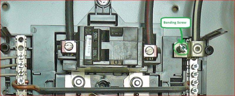

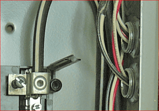

This morning we found that bonding screw present but not engaged. It's green and prominently located.
There are places where you should not tie neutral to ground so the factory left the screw barely inserted into the plastic, assuming a knowledgeable electrician would make the installation.
The factory put the screw there but did not run it in far enough to make the connection, making it electrically not there.
To make it bond you must run it in about twenty turns to engage the metal then tighten to 45 inch-pounds.
That explains why there were not pyrotechnics , neutral bar was not grounded .. Except maybe very briefly through the satellite dish which doesn't work anymore.
Could easily have made a real fireball.

here's a photo of same brand panel . I dint take any pictures, this is just an internet find..
You can see that the bonding screw is not tight.
Observe white stripe on big wire which indicates it's the neutral .
On site where this photo came from they explain it's a sub-panel not a service panel . Those terms have specific meaning in electrical code see those tutorials linked earlier.
In a sub-panel you don't bond neutral to ground and that's why this one wasn't tightened.
In this one ground is via metal conduits connecting the panels.
If there's no metal conduit as in NM wiring(often called Romex which is a brand name) there'll be a ground wire too, the bare ones that Averagesupernova mentioned.
