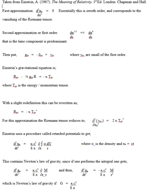

The issue of whether I am misinterpreting GEM is not one I can answer myself, as that would imply full understanding! However, my understanding of GTR originally comes from reading the great man himself, see below:
This shows how the zeroth order with the vanishing of the Riemann tensor gives flat Minkowski space. The first order corrections give Newton’s law of gravity which is an inverse square relationship like that of Gauss’s law in electrodynamics. Both ΛCDM and MOND are essentially first order corrections; in the first one adds mass but keeps Newton’s law of gravity; in the second one modifies Newton’s law of gravity, but preserves its essence.
I would consider that both Cooperstock and Deur are moving beyond a first order analysis by using a more subtle gravitational field approach. The question remains whether or not this succeeds in removing the requirement for dark matter or any modification of existing laws of gravity.
It would appear to be so judging from numerous analyses comparing these methods with actual observational data: Cooperstock’s own papers (see #207), Stuckey et al (see #2), de Almeida et al (the paper suggests otherwise but the graphs contradict their premise), and Lasenby et al (see #200 - again despite their claim their Miyamoto–Nagai density profile analysis gives the right answer).
This is all mixed up. Lambd-CDM is a full GR cosmology model. There is no approximation whatsoever in all its defining equations; it is fully non-linear. To perform some types of calculations more easily, one sometimes approximates the full model in various ways. MOND has no relation to GR, it is (in its original form) a modifications to Newtonian mechanics that happens to explain a bunch of esp. galactic observations. It is generally treated as suggestive of the idea that more plausible modified gravity theories are worth pursuing (in itself, in the original form, it is worthless because it fails to match any of the dozens of verified GR predictions that differ from Newtonian.
