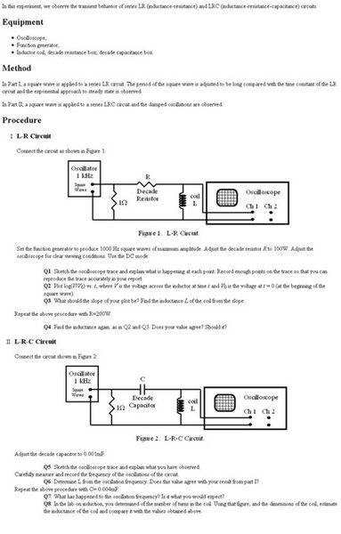

LR(C) Circuit help me please!
1. I really need help understanding this. Anyone who can walk me through this or at least push me in the right direction is most appreciated.
Lab procedure page for L-R and L-R-C circuits, with Figure 1 showing an oscillator, decade resistor, coil and oscilloscope in series, and Figure 2 adding a decade capacitor.
We don't do "walking through" here: you need to show some effort before you can receive help.
Well I tried graphing it in excel and it came out all messed up.I just need some sort of help, cause I am not understanding what went wrong.
