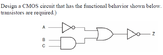

Hi all,
Having some problems digesting on electric circuits. Below is an example of a question and I would like to ask how do I go ahead in solving this.
Firstly, for these types of questions:
Transistor-level schematic of a CMOS AND-OR-INVERT gate with inputs A, B, C, D, output Z, supply Vcc, and transistors labelled Q1 to Q8.
I have understood how to write a function table, and it goes something like this:
Truth table with inputs A, B, C, D and output Z, plus columns showing on/off states of transistors Q1 through Q8 grouped under A, B, C and D; Z is 1 for ABCD = 0000, 0100 and 1000.
Now what I am having problems with is constructing the equation and the logic circuit. I searched online and found that the equation is simply the sum of all the variables that will give a HIGH, which in this case, is z = A'B'C'D' + A'BC'D' + AB'C'D'
Is this correct?
If it is, how do I then determine how the logic circuit should be drawn? I'm pretty confused on how do I even start one.As for the second question, it is simply (I guess a reverse) of the above question. It tells me to design a CMOS circuit given an equation:
Boolean expression z = NOT A + (B AND C), with the overline spanning A only, written as z = Ā + (B · C).

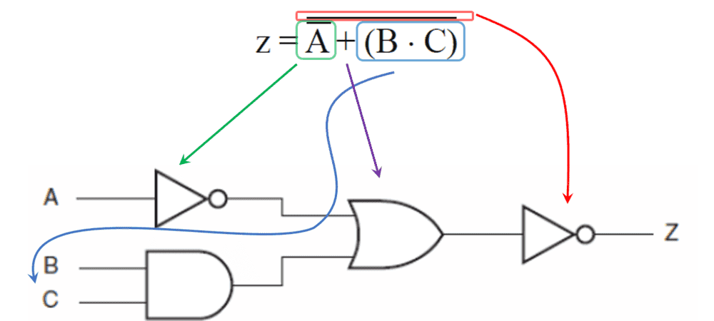

I managed to derive the logic circuit based on the equation, which is:
Logic circuit diagram: input A goes through a NOT gate, B and C feed an AND gate, and the two outputs feed an OR gate whose output passes through a NOT gate to output Z.
Now,how do I draw the CMOS circuit? Quite overwhelmed :/
Anyone who can refer me to some videos/reading materials on this would be great. I don't understand how do I simply draw one :/
Thanks!

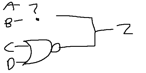

Ok, I'm not exactly sure how does one draws the logic circuit from the equation, but I will try my best to understand you.
So, in this case, both C and D are inverse. So maybe something like this?
Hand-drawn logic circuit: inputs A and B with a question mark beside them feed a wire to an OR-style gate, inputs C and D feed a NOR-style gate with a bubble, and its output combines into a line labelled Z.
Wouldn't it be like (C'D')+(A..B..) ? I'm not exactly sure of how can one 'derive' the logic circuit?
I don't want to give the answer, but it's exactly the same approach you used for the second problem. I'm going to simply copy and paste what you had in the original post and draw a few arrows to emphasize what each part of the equation meant in terms of schematic logic.
Logic circuit diagram with color-coded arrows linking the expression z = NOT A + (B · C) to its gates: an inverter on A, an AND gate on B and C, an OR gate, and a final inverter producing output Z.

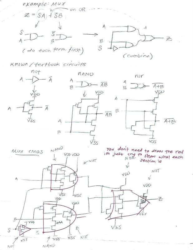

The CMOS circuit by the way is practically solved here. Say for instance you know what an inverter circuit is. Do you see right after A you have an inverter here? Replace the inverter with the lower level circuitry that uses transistors instead for your CMOS version of it. The OR followed by a NOT is very convenient because NOR is two less transistors than an OR and it's probably in your textbook. The only "trickier" one is the AND because your textbook probably shows you how to do a NAND, but you can copy your textbook NAND and follow directly behind it an inverter for AND.
Again: I don't want to give you the answer so I'll show you the approach for another classic circuit called a multiplexer (MUX). I just did this on the fly so apologies for some scribbles and potential error although the intention is to share the approach or recipe for solving a "hard" problem in small easier steps.
Handwritten notes deriving a 2-input MUX from Z = SA + SB̄ with AND, OR and NOT gates, then CMOS transistor-level versions of NOT, NAND and NOR, and a MUX built from NAND, NOT and NOR stages.
By the way I've heard the MUX is a common interview question.

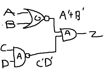

Ok, I redid some stuff and here's my attempt:
= (C'D') * (A'B'+A'B+AB')
= (C'D') * (B'(A'+A)+A'B)
= (C'D') * (B'+A'B) since a+bc=(a+b)(a+c)...
= (C'D') * (A'+A)(A'+B')
= (C'D') * (A'+B')
Logic circuit diagram: inputs A and B feed a NOR gate with output A'+B'; inputs C and D feed a NAND gate with output C'D'; both outputs feed an AND gate producing Z.
Something like this?

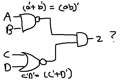

Ok, I think I figured out. (ab)' = a'+b'
a'b' = (a+b)'
So, for (C'D') * (A'+B')
Handwritten logic circuit: inputs A and B feed a NAND gate, inputs C and D feed a NOR gate, and their outputs go into an AND gate producing output Z; labels read (a'+b') = (ab)' and c'D' = (C'+D')'.

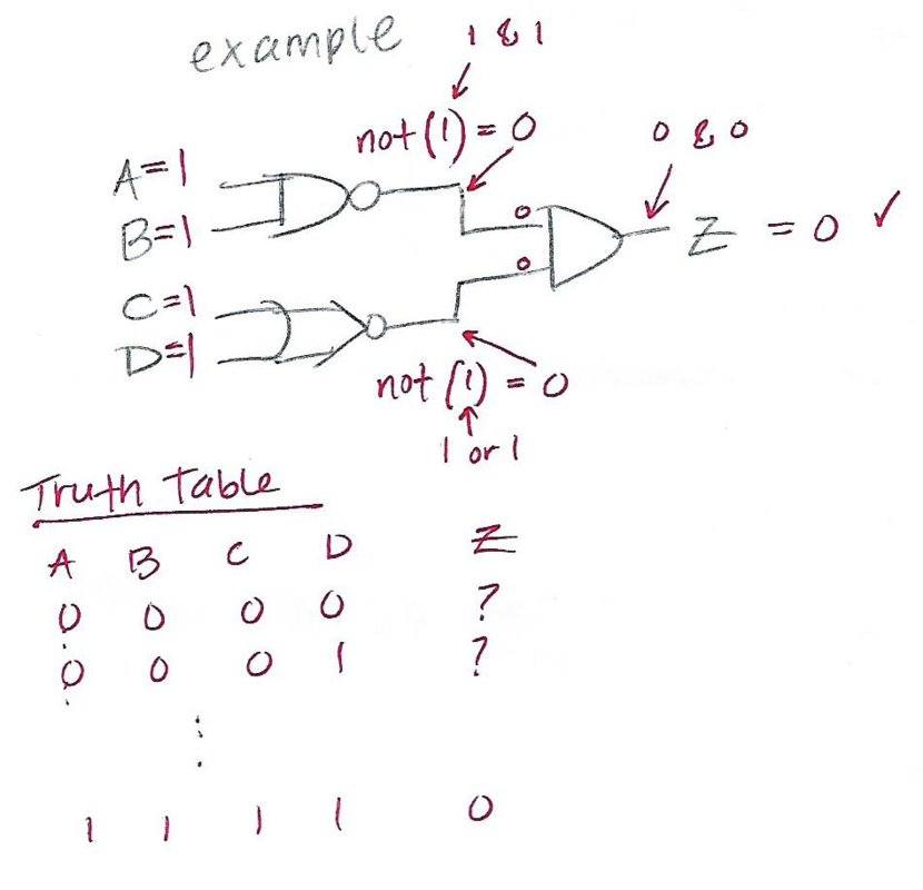

Handwritten example circuit: inputs A=1 and B=1 feed a NAND gate giving not(1)=0, inputs C=1 and D=1 feed a NOR gate giving not(1)=0, both outputs feed an AND gate with output Z=0, and a truth table with rows A B C D and Z below.
You can check all of them, which would be recommended if it's homework and/or if you're not feeling confident with your solution. If you're in an exam you can spot check a few points and check the rest after you've finished the exam and if you have enough time. The first one I checked for you looks like it matches the table so far; the answer doesn't look outrageous to me.

Hmm.. In this case, I'm kind of sure my answer is correct, but from the solution I have gotten from my friends, it appears that the last part of the circuit is wrong where just before the output, instead of a AND, it's a OR. So I'm kind of stuck I guess?
I just tried it with another test case to see just before that last AND if it should have been an OR.
OR I know if the inputs are 1 or 0, then the output is 1. AND the input are 1 and 0, then the output is 0. Let's try to get inputs like these into your last AND.
I tried ##A=0##, ##B=1##, ##C=1##, and ##D=1##. This makes the top one with the NAND become a 1; the bottom NOR becomes a 0. Now the input to my AND is 1 and 0, which has the output of a 0. I took a look at the table and that seems to work with the table so far. If you immediately swapped the AND for an OR you'd be in trouble.
Run through your truth table.

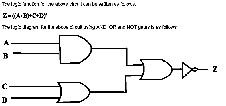

Just ran through, so it seems that the answer key is wrong? :H
This is the answer key:
Logic circuit diagram with inputs A, B, C and D: an AND gate combines A and B, an OR gate combines C and D, a further OR gate combines their outputs, and a NOT gate gives output Z; the logic function Z = ((A·B)+C+D)' is printed above.
No. It's the same as your answer. They pushed the bubble (DeMorgan's), which was what I was trying to talk about in that last piece.
See the OR gate at the back followed by the NOT? Let's say those two intermediate nodes are X and Y. Then you've got ##(X+Y)'=Z##, right? Remember DeMorgan's? ##(X+Y)'=X'Y'##. Now it's an AND with two NOTS into the input (##X'## and ##Y'##). Keep going from right to left move those NOTs to the end of the first circuits and you've got exactly what you had. If you ran through the truth table for this circuit you'd see that the answers are the same.
