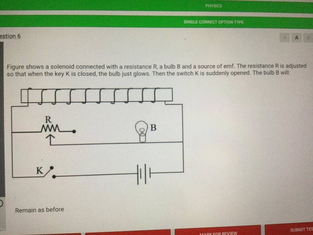

Anirudhhades
Guys in this question I think that once the switch is opened the current doesn’t immediately drop to zero but reduces at some exponential rate but at the very instant the source of EMF is removed the currrent in the circuit must still be equal to the current when switch was closed and hence the brightness of the bulb remains same
The options are:
A) Remains same as before
b) The bulb goes out
C)Glows very brightly
According to answer key the answer is C)
But I think the answer should be A)
Please help me out!
I=I (e^-Rt/L)

The branch with the bulb and the switch are conected parallel with the coil. What do you think where is the current higher when the switch is closed? through the bulb or through the coil?
Aargh! Another poorly written homework problem. Is there any prior information about what the resistance of the solenoid is (or the current through it when the switch is opened)? Maybe from another question or lecture. The question relates to how much solenoid current compared to the lamp current.
Theoretically, inductors (solenoids) have zero resistance. In the real world they don't, and this circuit makes no sense unless that current is limited somehow.

A badly written question, but can you answer these hints?:
1) While switched on, does the the coil have a current through it?
2) While switched on, does the the coil have energy stored? If so, what sort?
3) While the switch is (virtually instantly) being opened, what can you say about the time the current (from the battery) takes to drop to zero?
4) While the switch is (virtually instantly) being opened, what can you say about the rate of change of current through the coil? And what can you then say about the induced emf across the coil?

I think the correct answer is B) The bulb goes out EVENTUALLY. It's the only thing I'm sure of since the only energy source is removed and I don't believe in perpetual motion machines. But along those lines, your answer of A) It remains the same as before, can be true initially, but it can't stay that way forever.

It's not clear what you mean when you say "the currrent in the circuit." There are three branches in the circuit, and each has a current running through it. Which current stays the same when the switch is opened?

Hi Anirudhhades. If you attempt to answer my 4 hint-questions (post #4) I'll explain why these lead to choice C.
