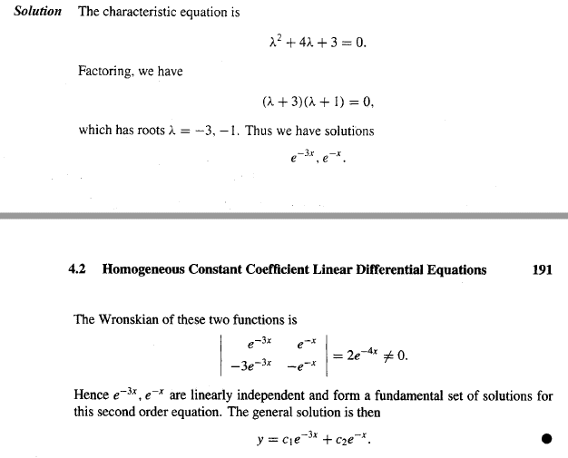

Sorry, I really have no idea what your question is. You've solved the DE correctly (well, you could write $y=c_1 e^{-2x}+c_2 e^{-3x},$ but you've done all the hard work), what else is there to do? Not sure what the problem statement means by "convert". Does the book define that term?

karush said:
ok here is the example I am trying to follow
The word "convert" does not appear in that at all. It does not appear to have anything to do with your original post. To "convert" something means to "change" it to something else. What were you to convert this equation to?
Is this related to your subsequent post where you were to "convert" a second order differential equation to a system of first order equations?
If so, then letting z= y', z'= y'' and the second order equation y''+ 5y'+ 6y= 0 becomes z'+ 5z+ 6y= 0. The "system of first order equations" is
y'= z
z'= -5z- 6y.
