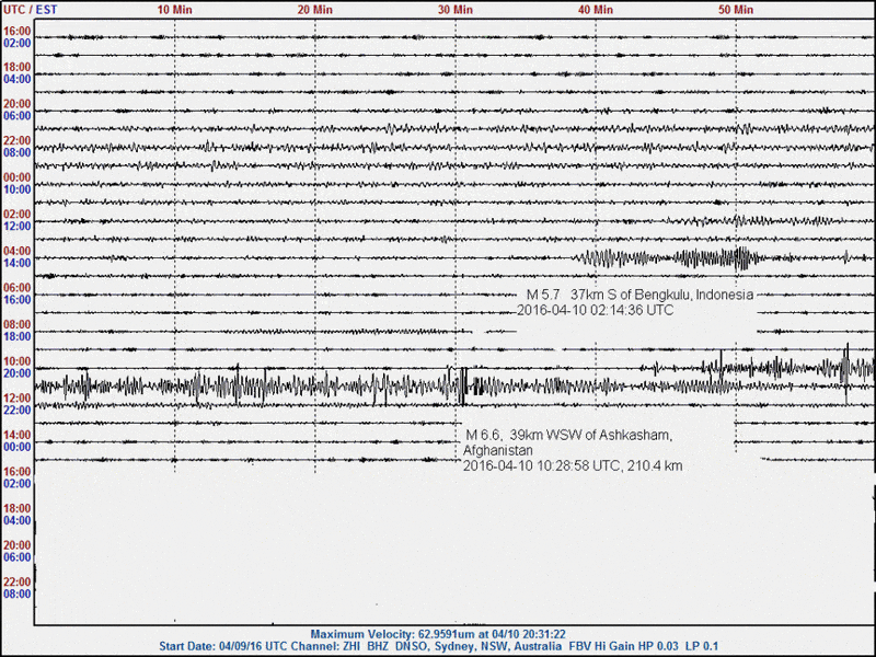

Astronuc said:
Did you detect that one Dave?
http://earthquake.usgs.gov/earthquakes/eventpage/us20005gsg#general
2016-04-10 10:28:58 (UTC)
Location: Lat 36.492°N, Long 71.156°E
Depth: 210.4 km (130.7 mi) - moderately deep
http://earthquake.usgs.gov/earthquakes/tectonic/images/himalaya_tsum.pdf
I notice some smaller quakes up that way, perhaps a few weeks ago.
Yes I did, but being quite deep, it lacked the good surface wave activity
cheers
Dave
