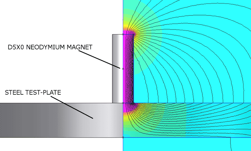

I have been bothered by that way of thinking because of the following thought experiment. An astronaut lands on a small planet whose outer mantle had been blown off so that it is nothing but a smooth cooled down nickel-iron core. He then places a large ordinary bar magnet upright on the surface with its N pole at the top. For all intents and purposes he now has an isolated N pole because the S pole has “vanished” and he can slide his monopole over the surface of the planet until he decides to lift it up.

Well I was’nt seriously trying to claim that such an arrangement was a meaningful magnetic monopole but I was seriously trying to see that a magnet had an exact counterpart in the electrostatic domain. From the point that you made I wish I could see what the magnetic field lines would actually look like from a bar magnet standing up on an iron planet.
They should look pretty similar to the following picture (from this site):
Simulated field plot of a cylindrical D5X0 neodymium magnet standing on a steel test-plate, with curved black field lines and a colour gradient from magenta at the poles to cyan in the surrounding space.
  • Simulated field plot of a cylindrical D5X0 neodymium magnet standing on a steel test-plate, with curved black field lines and a colour gradient from magenta at the poles to cyan in the surrounding space.
Well yeah. You can make a water fountain that sprays water in all directions -- if you don't count that little pipe coming up to where the orifices live.
Thanks for this but I am not convinced that a steel plate is like the situation I described. Let’s say the whole planet is made of soft highly permeable iron. The whole planet now has become the bar magnet’s S pole . Surely the field lines from where the bar contacts the planet will be pulled well into the planet before bending round and they would not crowd just along the surface because they are not restricted as in a thin plate. Therefore the magnetic field lines will now be enormously spread out.
Perhaps. Someone else will have to answer that, as I admit I don't know.
