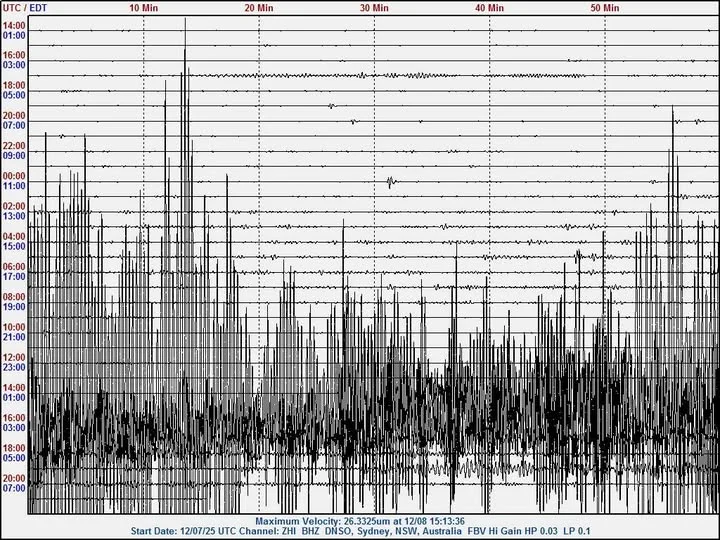

M7.6 Japan quake on my seismo (Sydney, Australia) this morning

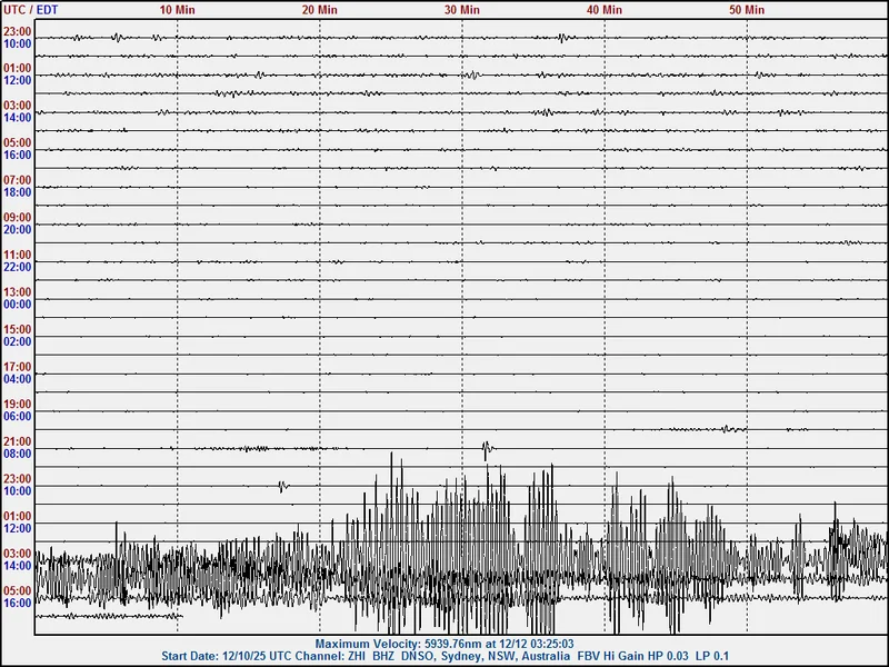

Another strong aftershock just tailed off on my seismo
M 6.7 - 114 km ENE of Hachinohe, Japan​
  • 2025-12-12 02:44:11 (UTC)
  • 40.918°N 142.745°E
  • 10.7 km depth

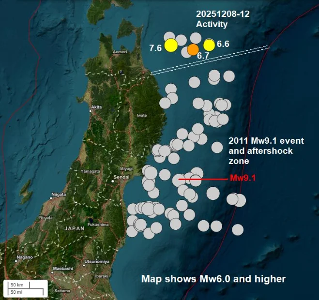

This has been a significant quake and not directly related to the Mw9.1 megathrust quake that occurred on 11 March 2011 at 05:46 UTC which has produced some significant aftershocks since 2011, particularly during the 2021 - 2022 period when many M6+ to M7+ events occurred within the aftershock zone.
I would like to suggest that this latest series of quakes, that include the 3 largest ones of Mw7.6, 6.6 and 6.7 appear to be far enough north of the aftershock zone of the Mw9.1 to produce a distinctly separate series
of events.
The only direct relationship would be that they are all on the subduction zone of the Japan Trench.
A possible indirect relationship could be the change in stress fields along the subduction zone as a
result of the Mw9.1 event. This is generally most easily observable at either end of a rupture zone.
These are thrust events, typical of subduction zones and moment tensor solutions as shown below...
cheers
Dave
