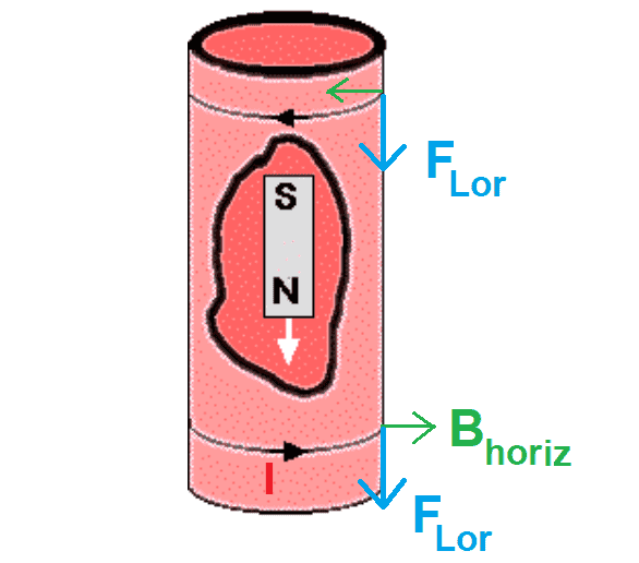

  • #37
I was just trying to understand the vertical forces, in a classical way. Basically comparing the heavy magnet sinking through a fluid of electrons to a heavy object sinking through water. Where I said "zero resistance", "very low resistance" would do just as well, it is not a fundamental thing. The video and the discussion helped me understand that the main vertical force is viscous, and that it depends on the vertical speed of the magnet relative to the electrons. While the electrons exert an upward viscous force on the magnet, the magnet exerts an equally large downward force on the electrons.
The return wire was a just simple way make the vertical motion of the electrons independent of the immobile copper atoms.

  • #45
So, that's a nice sounding analogy. But how will you know if it actually describes what things do in the real world?
There are some problems that you just really can't do very well based only on popular science. There is a reason physicists take a lot of physics classes.
  • #46
Maybe by measuring the voltage between the top and bottom of the pipe. The force FLor pushes the electrons down, so theoretically a voltage is to be expected.

No, that's not really what I'm asking. I do realize that the retarding force that slows down the magnet is a result of eddy currents that are induced by the falling magnet. And those eddy currents flow along the circumference of the tube. These eddy currents form, so to speak, a single-turn electromagnet that repels the falling magnet, hence retarding its motion. So far, so good... I hope.
Now my question is more like this... Let the terminal velocity of the magnet in the usual scenario be ##V_t##. Now let the whole tube move upwards at a velocity ##0.1 V_t##. I would now expect the terminal velocity to be ##V_t## with respect to the tube , but ##0.9 V_t## respect to the lab. Again, so far so good... I hope.
Finally, here's my possibly incorrect conclusion: "It should not matter whether that ##0.1 V_t## happens to be the velocity of the tube moving along with the electrons (as in the last paragraph), or it happens to be the velocity of the electrons alone, with the tube kept fixed (with the electrons being driven upwards by a battery at velocity ##k V_t##)".
IMHO, the resolution to my wrong conclusion would be interesting and intriguing to many people with approximately my level of physics. And I'm hoping that it can be explained in an accessible way in the style of Steve Mould et al.

hutchphd said:
Something attracted to the electron will likely be repelled by the proton and vice versa.
Please correct me if I'm wrong, but the eddy current electrons are (magnetically) repelling the magnet, not attracting it? That is, the eddy currents form a single-turn electromagnet with its (e.g.) North pole facing the approaching North pole of the magnet?
If this is correct, then then the protons can't exert an opposing attractive force, because they aren't circulating in a current and hence can't exert magnetic forces? In other words, the protons aren't cutting through the magnetic field in the same way that the electrons are, hence no attractive magnetic force.
