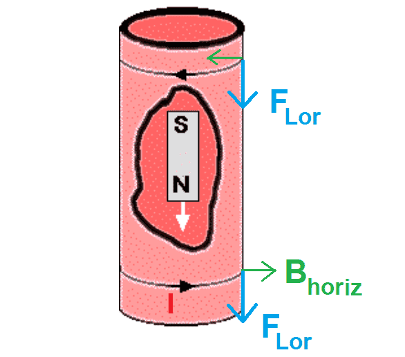

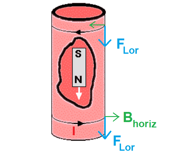

According to Newton's third law, the electrons participating in the eddy current are inevitably pushed down. If the copper pipe has zero resistance, and is infinitely long, I would expect the electrons to fall down, in a frictionless medium.
If vertical motion of the electrons somehow would be prohibited, for example by replacing the vertical pipe by a stack of copper rings separated by gaps I would expect a terminal velocity to be proportional to the resistivity of copper, ρ. (Something like v ∝ ρBmg). But in the copper tube electrons are free to move vertically.

What force "drags the electrons down"? The induced electric force is circumferential. Do you understand Faraday,s Law?
The Lorentz force on the electrons that participate in both eddy currents is downward, if the magnet is falling downward
It's not the Lorentz force. The Lorentz force is the force on a moving charge by a stationary B field.
In this case we use the Faraday law. That law states that an E field is induced in the metal circumferentially according to ## \oint \bf E \times \bf dl = - d\phi/dt. ## The minus sign is what makes your assumption as to axial force direction wrong.
If the calculus confuses you, use Lenz's law: the current buildup must be such as to counter the change in the incoming B flux. Looking at your bottom current, the B flux is increasing downward and the right-hand rule applied to the current pushes it upwards, opposite to gravity. Your picture is good, though, in every way including current directions.
