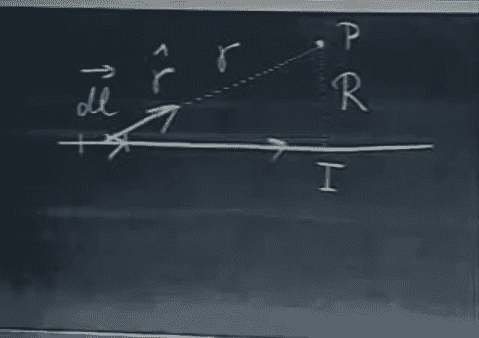

Handwritten chalkboard diagram of a long straight current-carrying wire labelled I, with an arrow along it, a point P at distance r from a dl element, unit vector r-hat, and perpendicular distance R to P.
Whilst revising the Biot-Savart law, I came across the result:
Equation B = μ₀I / (2πr), giving the magnetic field magnitude of a long straight wire carrying current I at distance r.
for the magnetic field due to a long straight wire. I understand that this can be found by integrating the Biot-Savart equation over the length of the wire, however after attempting the integral myself and looking at the integration in my notes I find myself unable to understand how to come to the result.
Biot-Savart law written as B = (mu_0 / 4 pi) times the line integral over C of I dl cross r-hat divided by |r| squared.
Outlined above. Any help will be appreciated, thank you.
Could you clarify what confuses you about the integral? The way to set it up would be as an integral over [itex]z[/itex], say, along the wire, with each wire element [itex]dz[/itex] contributing to the field at P based on the distance to point P and the angle between the radius vector and the z-axis.

In order to do the integral, you have to write it in terms of a single variable. Here, the writer chose s as the variable of integration, so he has to eliminate ##\theta## and r in favor or s. R is a constant as far as the integral is concerned.
This is not the only way to do it. You can also do it by using ##\theta## as the integration variable, in which case you have to eliminate s and r. You should of course end up with the same final result.
You can also (at least in principle) use r as the integration variable. I've never done it that way in this particular example, but I've done something similar in other situations.

Oh ok yeah I see, however I still do not understand this relationship then:
sin(∏-θ) = R/(s2 + R2)0.5
Theta is the outside angle in that diagram, pi-theta makes it the inside angle so that you can use the simple definition (sin theta = opp / hyp) to remove the theta from the equation.

Thank you, I fully understand the derivation now!
