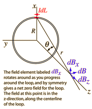

Can I derive an equation for magnetic field inside a solenoid using the formula for magnetic field on the axis of a current carrying coil?
B = μI/2r ( Magnetic field at the centre of a current carrying coil)
B = μI/2r
Let the number of turns per unit length of the solenoid be 'n' and its length be 'a'
So,
B = μnaI/2r
Which is definitely not equal to μnI (Calculated using Ampere's Circuital Law)
What's wrong?[/B]

The application of the Biot Savart Law on the centerline of a current loop involves integrating the z-component.
The symmetry is such that all the terms in this element are constant except the distance element dL , which when integrated just gives the circumference of the circle. The magnetic field is then
So, if we apply the same,
z = 0 (At the centre of the loop)
So, B = μI/2R
Isn't it correct??
It is correct for the magnetic field at the centre of a single loop. If you have a coil, all loops have their magnetic field inside the other loops. You should use the formula for B(z) and sum (integrate) the contributions of all loops.

Rather than integrate per post #5 my hint is to form a closed loop going thru the entire solenoid middle and closing outside the solenoid. You can now apply Ampere's law to get B.
Hint: contributions to the integral outside the loop may be ignored.
