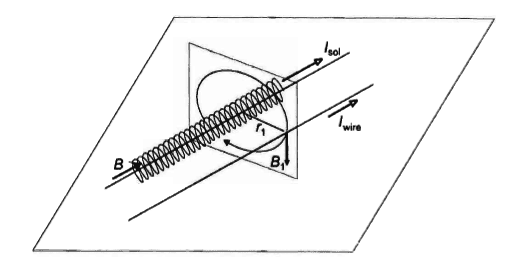

I found solution to problem 257 from "300 Creative Physics problems" hard to understand. In that problem we have very long solenoid with coil wounded in one layer. Data such as: density of turns, magnetic field at distance of 5 cm form the axis of solenoid and diameter (1 cm) was given. We hevo to calculate field inside the solenoid. Solution states, that "Because of the symmetry of arrangement, the magnetic field produced by the coil outside the solenoid is similar to that of a straight, current-carrying wire, as it is shown in the figure on page 474 [picture attached]."
Then, author used that fact and applied Maxwell second law to circle of radius 5cm. IMO, quoted text is meaningless. Magnetic field lines, which are eascaping interior of solenoid must "return" and re-enter that (Gauss law for magnetism). Also, they will never be perpendicular to the lines inside the solenoid, so they cannot be treated as circular field (produced by straight conducting wire). Please help!

At a distance of 5 cm from the axis of the solenoid, I believe the B field will be circular about the axis of the solenoid to a good approximation. That is, the field will be approximately the same as the field produced by a long straight wire located at the axis of the solenoid and carrying the same current as the solenoid. So, I think the solution given in the book is probably OK.
However, I don't understand the figure where the straight line that carries the current ##I_{wire}## is drawn at the location shown in the figure.

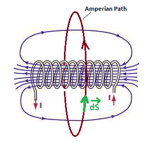

What do you get if you integrate ##\vec{B}\cdot d\vec{s}## around the circular Amperian path shown below?
(The figure is not drawn to scale: we are assuming a long, tightly wound solenoid and the radius of the Amperian path is ten times the radius of the solenoid.

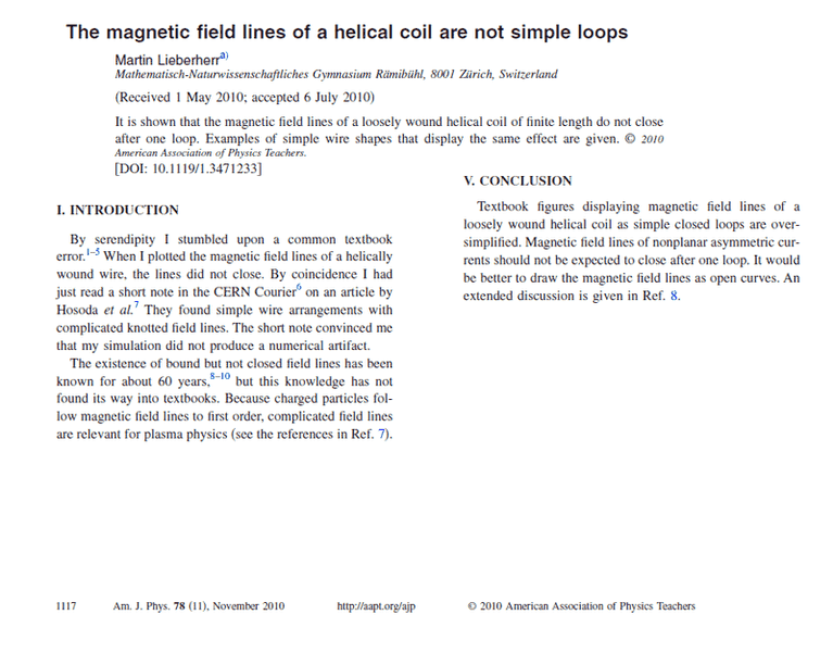

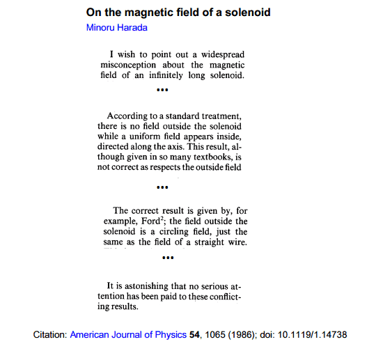

I was not able to find any computer drawn magnetic field lines that are accurate for a wire wound solenoid. In the process of searching, I did run across interesting comments in a few papers published in The American Journal of Physics. See some excerpts attached below which I tried to keep brief enough to avoid copyright issues.
Interestingly, magnetic field lines due to steady currents do not always form closed loops, despite what many textbooks claim. The lines can be quite complex.
