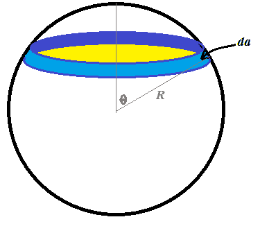

Show for a solid spherical ball of mass m rotating through its centre with a charge q uniformly distributed on the surface of the ball that the magnetic moment μ is related to the angular momentum L by the relation:
[itex]\textbf{μ} = \frac{5q}{6mc}\textbf{L}[/itex]
[itex]μ = IA[/itex]
[itex]I = \frac{2}{5}MR^2[/itex]
[itex]σ = \frac{q}{4πR^2}[/itex]
[itex]\frac{1}{T} = \frac{ω}{2π}[/itex]
Split sphere into thin segments, each one has magnetic moment:
[itex]dμ = dI \cdot dA[/itex]
where dA is the area enclosed by the segment:
[itex]dA = 2π r dr[/itex]
The current dI on each segment is:
[itex]dI = \frac{dq}{T} = \frac{ω}{2π} dq[/itex]
The charge on each segment is:
[itex]dq = σ da[/itex]
Where da is the surface area of the segment:
[itex]da = r^2\sinθ dθ d\phi[/itex]
This results in
[itex]dq = σ \cdot r^2\sinθ dθ d\phi = \frac{q}{4πR^2} r^2\sinθ dθ d\phi[/itex]
We now have an expression for dI:
[itex]dI = \frac{ωqr^2\sinθ}{8π^2R^2} dθ d\phi[/itex]
Now we can calculate the moment of each segment:
[itex]dμ = \frac{ωqr^2\sinθ}{8π^2R^2} 2πr dr d\phi dθ[/itex]
Integrating this over the whole sphere gives
[itex]μ = \frac{ωq}{4πR^2} \int^{R}_{0} r^3 dr \int^{π}_{0} \sinθ dθ \int^{2π}_{0} d\phi[/itex]
[itex]μ = \frac{wqR^2}{8}[/itex]
Obviously this is not correct, the answer I should be getting is
[itex]μ = \frac{wqR^2}{3}[/itex]
Where am I going wrong?

Is that the correct expression for the area enclosed? Can you describe the area that you are talking about? Did you make a sketch?
For a normal loop of wire, A would be the area inside the loop so in this case dA is the area bounded by the surface, da, of the thin segment. I have tried using the volume of the segments but the equation for magnetic moments requires an area, so I couldn't see how this would work.
Edit: I have seen on similar problems that the radius of each segment is rsinθ making the area enclosed:
[itex]A = πr^2\sin^2θ[/itex]
This may be where I am going wrong but I am struggling to see why the radius is rsinθ
The area enclosed by a circular strip on the sphere is shown in yellow in the figure. Can you express that area in terms of R and θ?

I see it now, thank you!
The radius of the segment is just simple trigonometry,
[itex]r = R\sinθ[/itex]
So the area now becomes:
[itex]A = πR^2 \sin^2θ[/itex]
Good.
