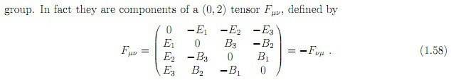

From http://arxiv.org/abs/gr-qc/9712019" by Sean M. Carroll:
That holds in flat space time but not in curved spacetime

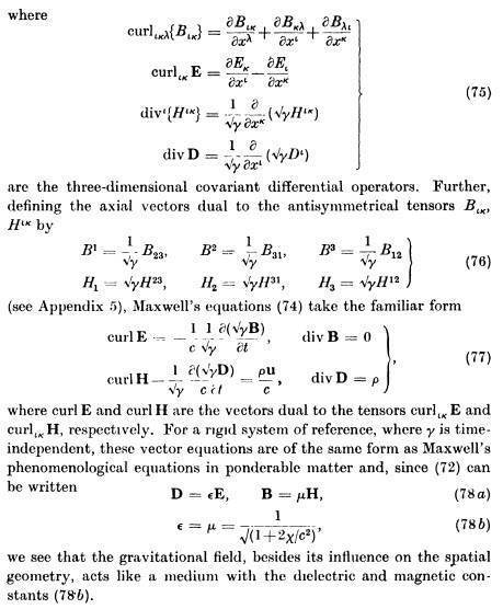

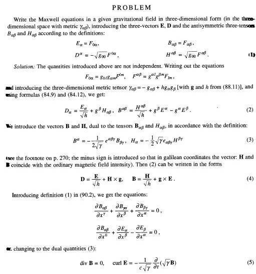

Landau, Lifgarbagez, "The Classical Theory of Fields", Vol 2, Fourth Revised English Edition, pp. 276-277

The approach by Landau and Lifgarbagez,as indicated by Arkajad:
[tex]{B^{\alpha}}{=}{-}{1/2}{\frac{1}{\sqrt{\gamma}}{\epsilon}^{\alpha\beta\gamma}}{F_{\beta\gamma}}[/tex]
[tex]{B^{\alpha}}{=}{-}{1/2}{\frac{1}{\sqrt{\frac{-g}{g(0,0)}}}{\epsilon}^{\alpha\beta\gamma}}{F_{\beta\gamma}{\neq}{g^{\beta\mu}{g^{\gamma\nu}}{F_{\mu\nu}{=}{F^{\beta\gamma}[/tex]
[ [tex]{\gamma}{=}{-}\frac{g}{g(0,0)}}[/tex]] ----------- eq 84.10 in Landau and Lifgarbagez
For such a definition we have
[tex]{\nabla}{B}{=}{0}[/tex]
The definition has been aimed to produce the above result. In fact the authors have remarked-----We introduce the vectors B and E………
[Please see attachment in Thread #10 ]

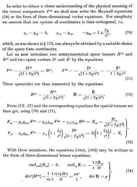

From C. Moller, "The Theory of Relativity", Oxford (1952) pp. 304-305

We consider the relation [from Moller]
[tex]{B^{\alpha}}{=}{\frac{1}{\sqrt \gamma}}{ F_{\beta\gamma}}[/tex] ------- (1)
In flat spacetime,
[tex]{B(f)^{\alpha}}{=}{F^{\beta\gamma}}[/tex] ----------------- (2)
Again
[tex]{B(f)^{\alpha}}{=}{g^{\beta\mu}}{g^{\gamma\nu<br /> }}{F_{\mu\nu}}[/tex] ----------------- (3)
Now if we transform from flat spacetime to curved spacetime, the left side of the last two equations transform to the left side of the first equation. Consequently the right sides of the last two should produce the right hand side of (1)
Considering the transformation from equation (3) to (1) we have
[tex]{ \frac{1}{\sqrt \gamma}}{ F_{{'}\beta\gamma}}{=}{ g^{{'}\beta\mu}}{g^{{'}\gamma\nu<br /> }}{F_{'\mu\nu}}{=}{F^{'\beta\gamma}}[/tex]
Implies:
[tex]{{{F^{'}}_{\beta\gamma}}{=}{\sqrt\gamma}{F^{'\beta\gamma}}[/tex]
[From (1) we have,
[tex]B^{'\alpha}{=}{\frac{1}{\sqrt\gamma}}{F_{{'}\beta\gamma}}[/tex]]
This inconsistency means that the quantity defined by equation (1) does not represent physically the transformed magnetic field.
But if we define:
[tex]{B^{\alpha}}{=}{F^{\beta\gamma}}[/tex] then
1)There is no inconsistency as such.
2)We have [tex]{\nabla}{B}{\neq}{0}[/tex]

But this is not the relation from Landau-Lifgarbagez. In Landau-Lifgarbagez they use 3-dimensional Levi-Civita symbol, which means it should apply only to the space-like part - it needs to be read from the context.
A good reference (though one needs to know differential forms to appreciate it):
http://mpej.unige.ch/~durrer/papers/threeplusone.pdf", by Durrer and Strauman
In my previous thread the indices refer to only to the spatial parts.
Regarding what has been said in Landau and Lifgarbagez:
[tex]{B^{\alpha}}{=}{-}{1/2}{\frac{1}{\sqrt\gamma}}{\epsilon}^{\alpha\beta\gamma}{F_{\beta\gamma}[/tex]
For example,
[tex]{B^{1}}{=}{-}{1/2}{\frac{1}{\sqrt\gamma}}{[}{\epsilon}^{123}{F_{23}}{+}{\epsilon}^{132}{F_{32}{]}[/tex]
Implies that:
[tex]{B^{1}}{=}{-}{\frac{1}{\sqrt\gamma}}{F_{23}}[/tex]
Essentially this is of the same content as that of C Moller
