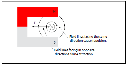

What do you mean by 'the lines of flux'. Or which lines on the diagram are they? This is what my online textbook did as an example. Did I do it right and they are just teaching it strangely?
Diagram of a current-carrying wire shown as a circle with a cross, inside a magnet marked N at top right and S at bottom, with a force arrow labelled F pointing left and dashed arrows labelled 'Field lines facing the same direction cause repulsion' and 'Field lines facing in opposite directions cause attraction.'
  • Diagram of a current-carrying wire shown as a circle with a cross, inside a magnet marked N at top right and S at bottom, with a force arrow labelled F pointing left and dashed arrows labelled 'Field lines facing the same direction cause repulsion' and 'Field lines facing in opposite directions cause attraction.'

I think you did reasonably well. It appears to be a somewhat introductory course, and what they asked for in regards to the magnetic field wasn't expressed very clearly. The magnetic flux lines from a horseshoe magnet are presented in the following "link" : https://www.nde-ed.org/EducationResources/CommunityCollege/MagParticle/Physics/MagneticFieldChar.htm Whether they were looking for these flux lines in their entirety is open for debate. Ideally, they would ask for this from the student, but it isn't completely clear whether this info was requested. ## \\ ## Additional item: They are teaching it somewhat strangely. (editing: In further consideration, what they are teaching works. It's not how I would solve it though. What they are doing sort of works from energy considerations, but the process as they are using it is in a very crude form.) ## \\ ## The force on a current carrying wire is ## \vec{F}=(\vec{I} L) \times \vec{B} ##. When I worked the problem, I determined the direction of the force by taking the vector cross product. The vector ## \vec{B} ## here is simply that of the horseshoe magnet, and does not involve the magnetic field from the current in the wire. The magnetic field from the current in the wire is not needed to determine the direction of the force on the wire.

You are asked to draw the magnetic field around the conductor. However, your drawing only needs to be accurate enough to answer the other two questions.

The direction it is wrapped around the piece of iron (clockwise or counterclockwise) is the determining factor here. The positive current is headed from right to left behind the north pole (at the top) of the magnet on the right hand side. If you just compute the lines of flux for this small portion of wire behind the magnet, when the circular lines of B flux are in the iron, they are going upward.
