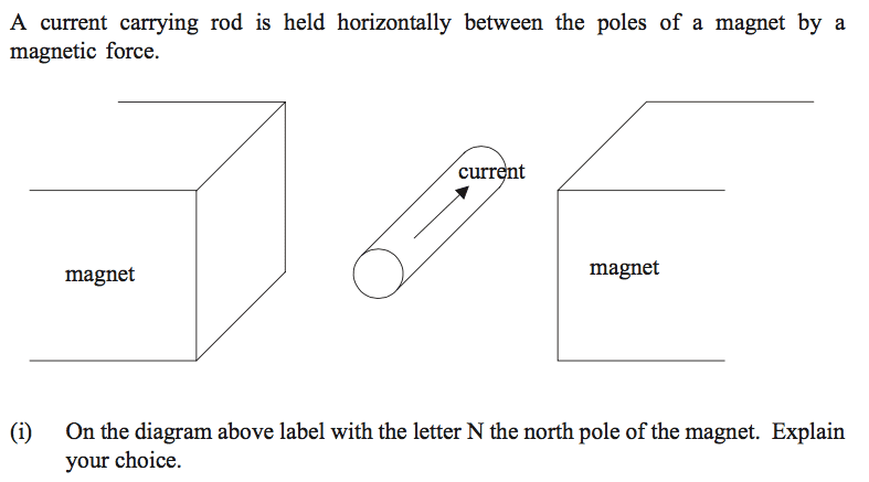

A current carrying rod is held horizontally between the poles of a magnet by a magnetic force.
magnet-current (into the page) -magnet
determine which side is the north pole of the magnet?
If I use the right hand rule, then the magnetic field direction is clockwise around the current.
Is this right? What do I do next?

This is the question:
You don't want the magnetic field created by the current. You want the force on the current due to the magnetic field of the magnet.
There are various right-hand rules and left-hand rules that people have invented. Most recent textbooks that I have seen talk only about certain right-hand rules and don't mention any left-hand rules. But if you are familiar with Fleming's left-hand rule, then you can use it for this problem.
The right-hand rule to which @Doc Al refers is just as good and will yield the same result.

Got it! Thank you so much~

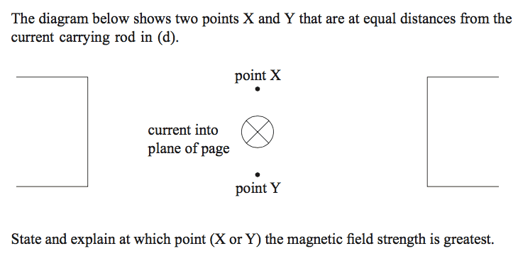

Hi, thank you! Can you please help me with this? It is a follow- up question of the previous one:
