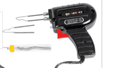

A secondhand soldering gun would be a good source of low voltage high amperage AC
and it's safe.
around five bucks in junkshops here..
