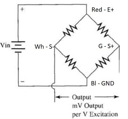

I would like to weigh our pet parakeets. They are rather skittish, so the idea I came up with was to hack a digital scale so as to put the controls and display some distance from the scale. Then I would add a perch to the scale. When one of our birds lands on the scale, I could turn on the scale, wait for it to fly off, and read the weight (displayed as negative number since most scales tare when they are turned on).
I know only about enough electronics to be dangerous. The scale I picked (like most) uses a load cell. I managed to extend the wiring from the load cell to the controls and displays by about 8 feet. I assume the circuit board does the signal amplification and digitization required to make the load cell useful.
The problem is that the display reading is always 0. It's possible I zapped a component, but there aren't that many (there's just one IC chip) and if things were zapped, I would expect the display to malfunction.
One thought I had was that the added resistance from 8 feet of wire affects the signals from the load cell, which I understand to be fairly weak. Ideally, one would amplify the signal before sending it down an 8 foot wire, but the amplification is probably done on the circuit board that drives the display, so that option isn't possible with this scale.
Before I try anything else, I'd like to hear whether the wiring length is the likely source of the problem from someone who actually understands electronics and load cells. Other ideas about things to check are welcome. Since my soldering skills are questionable, I used a continuity checker to make sure the connections from the load cell (red, black, white, and green wires) connect with the circuit board, and that no wires short with any others, which is about the extent of my troubleshooting.
As I noted, the display works. I can turn on the scale, and I can change the mode to grams, kilograms, ounces, or pounds. Whatever I pick, the reading is 0 and remains 0 no matter how I push on the end of the load cell.
One other change I made was to go from 2 AAA batteries to 2 AA batteries.

The number and colors of the wires indicate that it is a strain gauge load cell. A strain gauge load consist of four strain gauges connected as shown below:
The input voltage is typically 3 to 5 volts, but can be 1 to 10 volts or so. Normally, all four strain gauges (2 or 3 could be resistors) are all the same resistance. Typical resistances are 120, 350, or 1000 ohms. If the load cell is disconnected from the signal conditioner/amplifier, you can measure the resistance between any pair of wires. For 120 ohm gauges, that resistance will be either 120 or 90 ohms, depending on which pair you are measuring.
If the load cell is properly connected, you can measure the ##V_{in}## and the ##V_{out}## with any DMM. The ##V_{out}## will normally be zero to a few millivolts, and will change slightly if you push on the load cell. Disconnect the wires to measure the resistances, measure the voltages with all wires connected.
Lead resistance is typically less than one ohm, and should be roughly equal in all four leads. That being the case, an ohm or so of lead resistance will not significantly affect the operation of this type of load cell. All four leads should be in one cable, or at least twisted together, to reduce temperature effects.

jrmichler said:
If the load cell is properly connected, you can measure the and the with any DMM. The will normally be zero to a few millivolts, and will change slightly if you push on the load cell. Disconnect the wires to measure the resistances, measure the voltages with all wires connected.
Thanks. I think the red/black wire voltage was around 1.5 volts (not millivolts), half of the total voltage available from the two AA batteries. I tried other color combinations, looking to see if any voltages changed as I pressed on the load cell. I never got anything that reacted in any consistent way.
I can try this again more methodically. I have no idea which wires are Vin and Vout, though. Red and black would have been my guess, but the readings there aren't in millivolts and they don't change when I press.

Hmm... sounds like time for some serious troubleshooting.
Please start by telling us the resistance between the various wires and their colors. (color coding varies by manufacturer) I would expect the resistance RATIO of different wire combinations to be 4/3, as @jrmichler pointed out:
The simplest way to check for damage or a mis-wire is to eliminate the 8 foot extension cord. Re-connect the load cell directly to the circuit board (you did document the original connections, didn't you?) and see if the scale still works.
If no success there, either the re-connection is wrong (four wires have 24 different ways to connect, 6 of them may work) or something is damaged.
If it works you might want to identify which leads are the supply and which are the signal output. It can make later troubleshooting easier if you know what the correct voltages are.
Measure from each lead to the other(s).​
The combination with the highest reading are the supply voltage.​
The other lead(s) is/are the output.​
Most often, the voltage from an output lead to a supply lead is half of the supply voltage; AND the voltage between the output leads is zero or perhaps a few millivolts.
Now, re-connect that 8 foot extension cord one wire at a time, testing to see if it still works after each extension wire is connected.

Ok, this may take a while. As I understand it, I have to disconnect the wires from the signal conditioner/amplifier, which I think means that I have to unsolder the connections and then re-solder them when I want to measure the voltage. This is a pain.
Reconnecting is also a pain. There is no problem with documenting the original connections. The load cell has fine wires that were connected to the circuit board. All I did was cut them and then spliced 8 feet of wiring in between the cut ends. The splicing was done by soldering them to some small chunks of breadboard. To undo do this would take a while. The wires from the load cell are so fine that I don't even have a wire stripper that works.
I'd have to cut them from the breadboards, strip the ends very carefully, and re-solder them using a new chunk of breadboard. If the scale worked, then I could conclude the extra length of wiring was the problem. If it didn't work, then I hosed something. Neither of the two possible results would lead to my goal.
The four wires are colored. Connecting them properly is not a problem.

To verify the solder joints, I tested the continuity from the source load cell leads to the circuit board. I think we can eliminate "solder joint is bad".
I never soldered near the load cell, just the wires, so it's unlikely any soldering damaged the load cell. It might have been damaged by something else I did.
Same at the other end.
I think @jrmichler had the best suggestion. With power enabled and everything connected check the voltage and see if I can view a few millivolts change when pressing on the load cell. I think I've tried this, but it sounds like I should first identify Vout and check to see if it changes when pressing on the load cell.
By the way, the four wires lead to four circuit board connectors labeled Gnd, E+, S+, and one unlabeled. Which one is likely to be Vout?
Of course, if I see a voltage change, that means the circuit board is damaged. If I don't see a voltage change, then the load cell is damaged. (@jrmichler didn't think the 8-feet of wiring would be a problem). So again, it looks like no matter what I find, I'm done, so I could just not bother.
It seems there is no path that leads to a working system with the system I have. The question is whether this approach would work with another scale. If @jrmichler is wrong, and the 8-foot extra length is a problem, then there is probably little point in hacking another scale. Removing the 8-feet of added wiring would at least answer that question.
OK, I captured some voltages. I captured them at the source (output of load cell) and at the circuit board.
The first number is the source voltage, the second is the circuit board voltage.
B (Gnd) - W: 0 mV, 0 mV
B (Gnd) - R (E+): 3.447 V, 3.445 V
B (Gnd) - G (S+): unreliable, 1.493 V
W - R (E+): 3.437 V, 3.441 V
W - G (S+): 1.487 V, 1.485 V
R (E+) - G (S+): 3.44 V, 3.439V
Black to Green yielded varying values, so I'll need to work on that solder connection.
The only reliable mV reading was Black to White. This reading did not vary when I pushed on the load cell.
The display shows numbers (always 0 for the weight), but sometimes "Err", so that also points at a flaky connection. I'll look into this before giving up.
Based on your last two posts, this is what I think you have:
When the excitation voltage is 3.4 volts, there should be 1.7 volts from either W or G to B, and 1.7 volts from either W or G to R. There should be 0 or a few millivolts between W and G, and that voltage should change slightly when you press on the load cell.

Thanks! After I found the screwy Gnd to S+ connection (black to green), I re-soldered it and it fixed it! Then I screwed the scale's case back together and it broke. So I bit the bullet and I redid all the soldering using a fresh bit of breadboard and being a lot more careful about the soldering. That fixed it much more reliably. I tested it with some pennies (after 1983, they are 2.5 g), and the scale was still accurate +/- 1g.
I'm finishing the remote case right now. It was helpful to know that the 8 feet of extra wiring wasn't likely the problem. That led me to keep looking at the wiring. The continuity checks misled me; the voltage checks, done methodically, were more useful.
