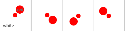

LightningInAJar said:
I just want to see numerical proof that each image is represented equally.
I'm not sure a numerical proof would convince you.
Here's a graphical proof though.
Here are 4 theoretical images:
Here is L1 at 100%:
Here is
L1: 100%
+ L2: 50%.
Notice how both large dots are the same intensity (50%). Why?
Any given pixel, anywhere in the image, is getting
50% contribution from L1 and
50% contribution from L2.
That 'contribution' may be red or it may be white.
Examine this until you are satisfied why it is true.Now, this is what happens with adding a third layer:
L1: 100%
+ L2: 50%
+ L3: 50%:
Any given pixel is getting
50% from L3
but only
50% from L2 and L1 combined.
L3 is over-represented.
The only way to get an equal contribution from each layer is
L1: 100%
+ L2: 50%
+ L3: 33%:
All three large dots are equally intense.
Satisfy yourself why this must be true.Finally, this is what happens with
L1: 100%
+ L2: 50%
+ L3: 33%
+ L4: 33%:
33% from L4 +
67% from L3 and L2 and L1 combined.
That 67% is divided 3 ways - that means L1, L2 and L3 are only contributing ~22% each.
At 33%, L4 is over-represented.
L1: 100%
+ L2: 50%
+ L3: 33%
+ L4: 25%:

I really appreciate the visuals. Not sure where you found those images. But I still don't know the math of why those fractions in particular are used. I know if there were 3 images and there was no order than each would be at 33%. It's like the bottom layer which is set to 100% if there were 5 layers total, then you need the influence of the top 4 layers to somehow add up to 80%. Not sure how to systematically know how to make that work.
I made them. In Photoshop.
You're going to need to go through it step by step before it will become intuitive.
Review post 22, from the top, down to where it says: "L3 is over-represented."
Convince yourself why the only way to get this:
is 100% / 50% / 33%.
If it doesn't makes sense, tell us exactly where it goes off the rails.
