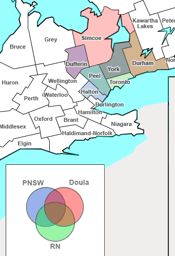

OK, I'm stuck on a problem implementing this map.
(It'll be built in HTML with JavaScript and CSS and is interactive but that's just context - this is really about map-colouring.)
The function of the map is to help users see at-a-glance what regions/counties of the province are serviced by three types of workers (PSWs, Doulas and RNs). (I will have rollovers and drill downs to provide another level of detail, but that's not exactly "at-a-glance").
The below map examples are at 100% scale. You can see by the size of the areas that I have very little room for details. That's why I'm preferring block colouring.
Here is a (bad) atttempt:
Colour-coded map of southern Ontario counties showing PSW (pink), Doula (green) and RN (blue) coverage, with labelled regions including Simcoe, Dufferin, Durham, York, Peel, Halton and Toronto.
County Simcoe is serviced by a PSW, county Toronto is serviced by a Doula and county Halton is serviced by an RN.
Counties served by more than one type are a combination of the colours:
County Peel is serviced by a Doula and an RN (green, blue)
County Dufferin is serviced by a PSW and an RN (red, blue)
County Durham is serviced by a PSW and Doula (red, green)**
County York is serviced by all three (red, green, blue)**.
** note that these are actual mixes of the colours at 40% opacity, so R and G don't make yellow and RGB doesn't make white.
Anyway, you can see how this doesn't work - it's not at all apparent what, say, purple represents.

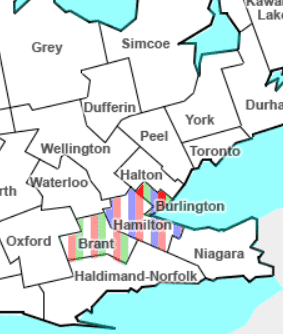

I tried this too, where the three colours are visible and don't overlap:
Map of southern Ontario counties including Grey, Simcoe, Dufferin, Peel, York, Toronto, Halton, Hamilton, Burlington, Brant, Niagara, Norfolk and Haldimand-Norfolk, with Halton and Hamilton areas shaded in colored stripes.
but it's pretty hideous ain't it?

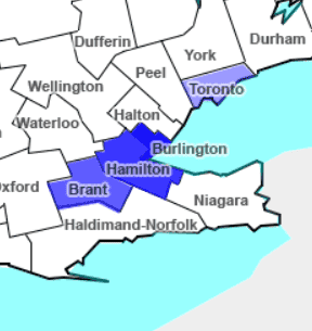

I'd like to be able to incorporate density of coverage at the same time:
Map of southern Ontario counties with Toronto shaded light purple, and Hamilton, Brant and Burlington shaded in darker blue tones; Niagara, Peel, York, Durham and Halton labelled.
So, Burlington has multiple RNs - much more than Toronto.
Suggestions?
Technically, this works without the legend getting out-of-hand...
I'm just not sure the colours are differentiable enough.
Map of southern Ontario counties and regions with a three-circle Venn diagram in the lower left labelled PNSW, Doula and RN, with overlapping blue, red and green circles.
I think even with perfect colour vision this is too great a cognitive load: the brain is just not used to separating 3 orthogonal axes from a colour map.

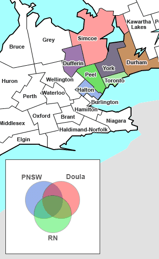

I am pretty confident that RGB - and the secondaries C, M and Y - are by far the easiest to identify. They are all colours we're intimately familiar with.
Any other three primaries will produce a rainbow with strongly overlapping segments, for example: green, yellow-green (is it green? is it yellow?) and yellow.
I'm going to move forward with this until I come up with something better:

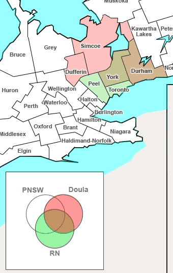

I've just added some functionality to make it much easier: the legend is comprised of hot spots to turn colours on and off:
Map of southern Ontario with county boundaries and labelled regions including Simcoe, Durham, York, Peel, Halton, Wellington, Niagara and Grey. Several areas are shaded pink, tan, green and white, and a three-circle Venn diagram in the lower left has circles labelled PNSW, Doula and RN.
Unfortunately, it doesn't facilitate a density parameter (yet).(I guess I may have to actually reinstall an editor after years. Notepad is a bit clunky for this.)

pbuk said:
Shame. How about 3 vertical or horizontal bars with relative quantity represented by relative area?
See post #1, pic #2. Hideous.
Well 2-way blends are easier to grok than 3-way I suppose, but it still doesn't work for me.
Too many stripes - I was thinking of exactly 0, 1, 2 or 3 for each region.
I kind of liked that one. It doesn't look great, but it's easy to grok the meaning, easy to understand the legend. When I see purple, I just don't think of red + blue. You may have to choose between pretty and easy to understand.
Me neither - and even worse for red + green = brown at low intensities, yellow at high intensities.
THats OK the legend makes it clear

I prefer the striped one. It's actually pretty easy to interpret at a glance.
The coloring blended version is absolutely terrible in terms of function.
I think you should make sure that the encodings of all of the colors in the map are clearly represented in the color map.
If you choose to mix colors, then rather than just blending one color over the other using transparency, it would probably be better to just take a linear combination of the colors (e.g. 0.5 * c1 + 0.5 * c2 ), and ideally in a more perceptually uniform color space than RGB. You might want to also consider colorblind friendliness.

FWIW - your scheme is not generally applicable. Period. You may not see it as a problem. Your call.
Colour (color) blindness (colour vision deficiency, or CVD) affects approximately 1 in 12 men (8%) and 1 in 200 women in the world. In Britain this means that there are approximately 3 million colour blind people (about 4.5% of the entire population), most of whom are male.
https://www.colourblindawareness.org
British site, but it obtains worldwide.
