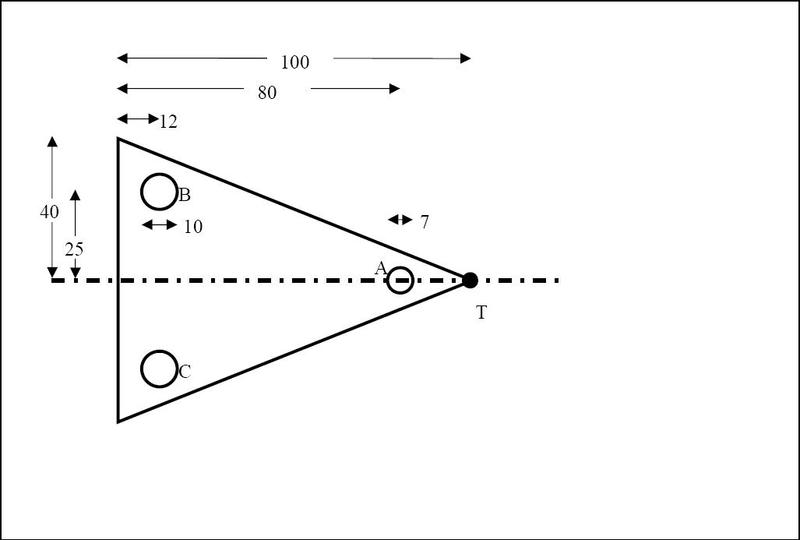

Find the mass moment of inertia about the tip T (into the page). All dimensions are in mm, and the density is 7820 kg/m^3. The thickness of the triangle is 10mm
I tried to do a triple integration over dV (as density is constant) and made r^2=x^2+y^2, then multiplied my final answer by the density. I used limits of 0 to 0.01 for dz, 0 to 0.1 for dx and -0.4x to 0.4x for dy. I'm not really sure if this was the correct method, does anyone have any other ideas? Thanks in advance. [my answer was 1.647x10^(-3) kgm^2]

I do not see the letter T. Is this the vertex on the line of symmetry with the black dot?

Yes, the letter T is the vertex of the triangle. It's not for a calculus course but the problem states that we need to use integration.
Excellent work, luznyr. Your answer is correct, ignoring the holes. Your method is correct.

Nice work :) I'm just a bit confused here, because I did it by another method and got a slightly different answer..
Consider a thin vertical strip with area dA = x / 100 * 80 * dx
therefore volume dV = x / 100 * 80 * dx * t
and IT = integral ( r^2 dm) over volume
= integral (rho * r^2 * dV) over volume
= integral (x / 100 * 80 * t * x^2 * dx), x = 0 to 100
= 0.001572 kgm^2
I would appreciate a clarification ;)
alias99: Although the problem statement in post 1 is unclear, luznyr is asking for the polar mass moment of inertia about a z axis passing through point T. The z axis is normal to the plane of the page. Your derivation is correct for the rectangular mass moment of inertia about a y-axis passing through point T (except you inadvertently omitted rho from one of your equations, and secondly, your answer is slightly inaccurate and should instead be 0.001564 kg*m^2.)
can u show exactly how u did it? I am curious haha.. triple integration about dV..
nvn, you're right.. I made 3 mistakes :redface:
1. should be Z-axis through T
2. I missed rho in an equation..haha..
3. I used 7860 instead of the correct density, 7820
I did it by luznyr's method and got his answer..Thank you very much for your help nvn, you saved me :smile:
