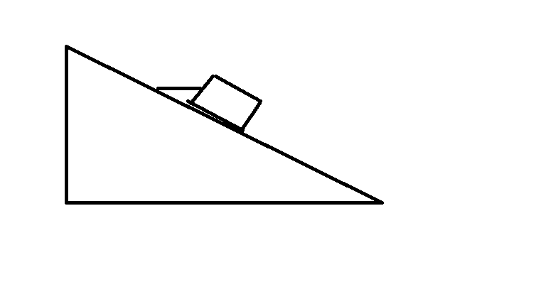

rpg711
A block with mass m1 = 9.2 kg is on an incline with an angle θ = 25.0° with respect to the horizontal. For the first question there is no friction between the incline and the block.
The coefficient of static friction was deterimined to be μ = .121
The premise of this question is that there was a spring holding the box up(the spring only exerting force in the X direction), but this spring was replaced by a STRING that is parallel to the horizontal, thus making a 25° angle with the incline.
Word for word, it is:
The spring is replaced with a massless rope that pulls horizontally to prevent the block from moving. What is the tension in the rope?

I am not sure if I am picturing this correctly, so I drew how I understand the situation. Correct me if that is wrong.
If not, then there is no component of tension force perpendicular to the incline, at the box. Notice that I have drawn all the forces on the box.
Nope, the string is connected in such a way that it is parallel to the HORIZONTAL, so it makes an angle of 25 degrees with the incline.
So there is a component parallel to the incline(Tcos(25)) and a component perpendicular to the incline that has to be factored into Friction/Normal force calculation (Tsin(25))
A clarification: In that picture, the dotted line is the string, so it is parallel to the horizontal.
Can you draw the correct setup?
Here's the correct setup
Ah, I see. It seems you have solved the problem in your first post. Below I have quoted it indicating the substitutions you need to make (replace darker shade by lighter shade of same color). I do not get a 0 = 0 so I'm guessing you made some algebraic error. Do it again and see if you still get such discrepancy and post it here if you do.
