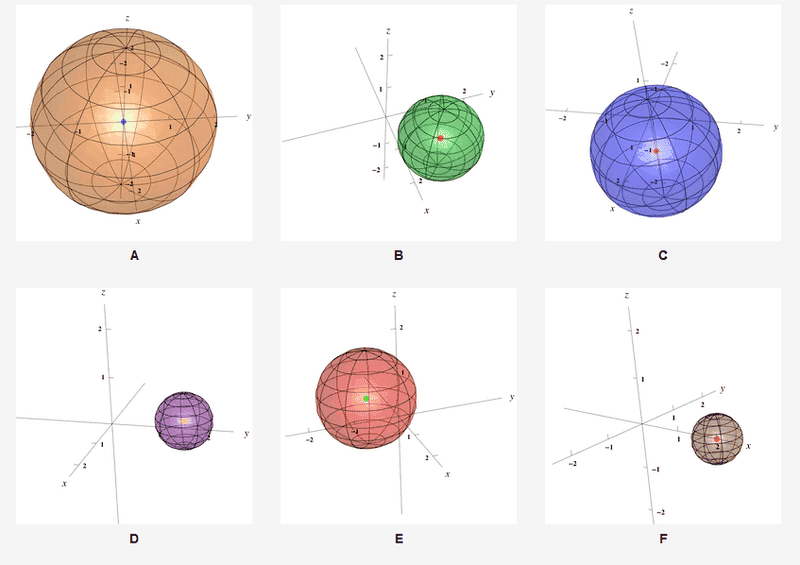

I have been given a problem with 4 equations, that need to be matched up to the corresponding image. I have worked the equations already and determined their center, but for the life of me I cannot seem to figure out which graph goes with which equation. The images are not that easy to read which is most of my issue. Here is an example:
x2−4x+y2−4y+z2−2z = -35/4 (original equation)
(x-2)^2 + (y-2)^2 + (z-1)^2 -9 = -35/4
(x-2)^2 + (y-2)^2 + (z-1)^2 = -35/4 + 9 >> √1/4 >> 1/2
C = (2,2,1) r = 1/2
This would give me a center of (2,2,1). However, none of the spheres I am provided appear to match this. Am I blind or does my math appear to be off?
(D) could fit. There are sign errors in your absolute values (doesn't influence the center, but influences the radius) - with your current number you would not get a sphere because the equation has no solution.

I see that, I have it written down correctly on my notebook, resulting in a r of 1/2. I appreciate your response, at this point I am more concerned with getting the correct values than matching to the correct graph. There are 4 total equations, and if even one of the choices are wrong it marks the entire problem wrong. Prevents guessing I suppose, but not very helpful otherwise.

My apologies for the typo, I corrected it in the original post. Ultimately, I have what I believe is the correct values, but I am not seeing a sphere whose center is (2,2,1) with a radius of 1/2. The attachment is the image with the spheres, I'm not sure if it shows up embedded in the first post or not.

I cannot see any sphere with center (2,2,1), or even close to it. Are you sure you copied down the original problem correctly?

This is the original problem, directly from my assignment. #1 is the one in question. I will say that I failed to use "^" on the 3 variables to plainly indicate that they are squared, but I treated them as such and completed the squares.
Just in case the attachment doesn't work, x^2 - 4x +y^2 - 4y +z^2 - 2z = -35/4

One of these equations fits one of the diagrams perfectly (as far as my eyes can make out). I can't say more without giving a way the solution.

I agree, I have worked out the other 3 equations and was able to match 2 of them with a diagram fairly easily. But I still have to figure out which one matches the 1st equation(all 4 equations are supposed to be represented in the diagram). Are you saying you do see one with (2,2,1)? If so that's good enough for me, and I will keep staring until I see it, haha. In any case I appreciate the help.
I see a sphere where (2,2,1) as center would fit. You cannot extract the coordinates from the images reliably (2 vs. 3 dimensions), but you can go the opposite way: see where (2,2,1) is in each image, and see if that matches the center of the sphere in the plane.

Neither can I see any sphere with center near (2,2,1) .
Do we see the same image?
To me it looks like the center is at about (0,1.5,0). However, as you said before, some of the figures are not very clear.

One thing is certain, this problem is more of a test of your visual skills rather than testing your ability to solve an equation.. I have reached out to my TA to see if there is any help they can provide as well. I appreciate the help everyone

You cannot uniquely determine the center of a 3D point from a 2D drawing without any additional help. The sphere in D is at the place where a sphere around (2,2,1) has to appear, and no other sphere fits.

Sorry, I don't understand the problem. We are supposed to find the right sphere for this equation, there is exactly one sphere that fits. What needs further discussion?

Just one of the four equations has been posted here, but this one fits to exactly one sphere.

If the problem statement doesn't seem to be right: sure. But here there is no problem with the problem statement. If you have to pick the answer to "5+5" and the options are "9", "10" and "15", you wouldn't expect a problem with the problem statement, right?
Here is the problem in its entirety. I didn't include everything initially because I did not have a problem with the other 3. My intention was to present it as if it was simply a problem with a single equation and provided with 6 possible solutions, knowing that one of them must be correct.
