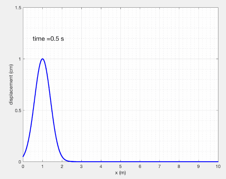

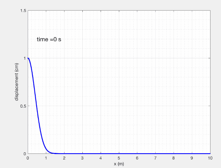

Consider a very long rope at rest on a frictionless surface and placed parallel to the ##x##-axis. If its left end is quickly shaken up and down once, a perturbation of the shape of a pulse propagates along the rope from the left to the right end. If there is no energy losses, the pulse will propagate along the rope without changing its original shape.
In the figure below, the displacement in centimeters of an ideal rope with respect to its equilibrium position defined by ##y=0## is shown. The travelling pulse is shown at different times. The speed of the pulse is ##2\text{m/s}##.
If the shape of the pulse at time ##t=0## can be modelled by the function ##y(x)=Ae^{-Bx^2}##, where ##A## and ##B## are positive constants, what is ##y(x,t)##, the mathematical representation of the shape of the pulse at any time ##t>0##?
My initial thought was to model the wave as
$$y(x,t)=Ae^{-B(x-t)^2}$$
This question is part of an automated grading system and the above entry is considered incorrect.
I think I need to incorporate the information that the speed of the wave is ##v## somehow.
First off, the expression ##x-t## is dimensionally inconsistent. Think about how this can be corrected.
Then yes, the speed must enter into it. How fast does the wave you wrote down move. Note that the argument = 0 is the peak of ##y(x)##. How fast does this peak move?
The answer seems to be just
$$y(x,t)=Ae^{-B(x-vt)^2}$$

No, the second picture is at t=0.5s.
The mix of variables and constants in the answer makes it a bit tricky.
Given the 2m/s speed, the correct way to write the answer is
$$y(x,t)=Ae^{-B(x-2tm/s)^2}$$
I don't know why you are writing "No".
The pictures are just snapshots in time, which is a continuous variable. I made a statement about a particular time, ##t=1##.
I also said the answer seems to be
I was the one who typed up the problem statement in the OP, so I know that ##v## is a known constant.
Nobody said anything about that plot though.

Because I thought you were trying to deduce the speed from the two snapshots, which I took to have been provided with the question. But maybe you generated those.
