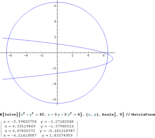

GreenPrint said:
Does anyone have any other solutions that might work?
Using Mathematica, I see that the problem amounts to finding the intersections between a circle and a parabola. There are only 4 intersections, so I would expect 4 solutions.
See the attachment:
  • Mathematica plot of circle x^2 + y^2 = 42 and parabola x + 3y + 2y^2 = 6, with four intersection points; below it, the N[Solve] output listing the four numerical solutions.
