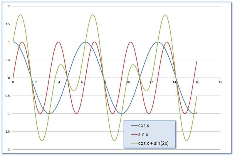

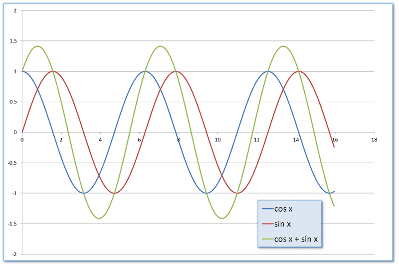

What do you get for the amplitude of ##\cos x+\sin x\ ## ? For ##\cos x+\sin (2x)\ ## ?

For ##\cos x+\sin x\ ##, i would get 2 , simply because ##sqrt(1+1)## = 2

For ##\cos x+\sin (2x)\ ##, I would also get 2, simply because of shape of ##\cos (x) \## will coincide after some time.

You must have seen plots of ##\sin x## and ##\cos x##.
## \cos x+\sin (2x)\ ## looks like this:
Functions coincide some times (with y=0), peaks don't !

That's not true at all.
##\sqrt{1 + 1} = \sqrt 2##.
