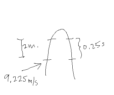

A ball thrown up falls back down in front of a window from where an observer sees the ball for a total of 0.5 seconds. The window is 2 m. tall. What is the maximum height of the ball?
1D Kinematic equations
I got that initial velocity from the bottom of the window by using [tex]V^2 = V_0^2 + 2a(x - x_0)[/tex].
I set the seconds to 0.25 since 0.5 is the total, and -9.8 for the acceleration of gravity.
Then I plugged all of that back into [tex]V^2 = V_0^2 + 2a(x - x_0)[/tex] by setting V^2 = 0 because the velocity at the highest point is 0, V_0 is the previously found initial velocity, acceleration is -9.8 again, and x - x_0 is the unknown. I got 1.88 m., which is obviously wrong because the window itself is 2m. But I guess it could be the answer, but I'm not sure. It doesn't look right.
How did you get the initial velocity from this?
Take maximum height as the starting point where the ball being dropped.
