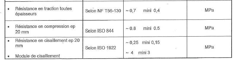

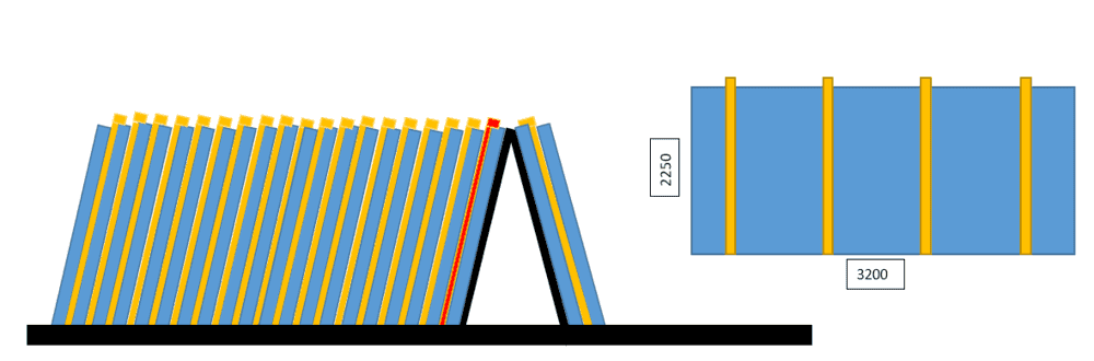

I search to know, how many pack the red interlayer on the drawing can support on an easel inclined of 4°.
One pack (blue in the drawing) = 2500kg
There can be max 20 pack of 2500 kg by side of the easel = 50000 kg
One pack measures : 3200x2250x140 mm
Interlayers are in polypro with section of 80x30 mm (see interlayer properties in attachment)
We have 4 interlayers for each pack.
Thank you in advance for your help.

Yikes, that's heavy stuff! What happens if the supports fail? What does the load end up hitting when it falls?
Hello Berkeman, thanks for the reply.
The easel is in steel and it is certified for this load for the 2 sides.
The question is on the red interlayer, if it fails, the last end pack in blue will be damaged. We had cardboard interlayer and it happened.
I want to make sure that in polypro there will be no more problem and know the maximum number of packs that it will support.
If I understand the question you are asking for the total force on the Red interlayer, the easy answer is 19/20 (95%) of the force on the easel.
Force on easel = 50000kg × Sin(4°) = 50000 × 0.07 = 3500kg
3500kg × 0.95 = 3325kg force on pack 20 by the 19 packs to the left.
I hope this helps. I do not understand the table you included, maybe others here will have a better answer.
Remember that the forces are when the package is not moved. If it shipped or handled roughly the forces could be several times higher.
If I understand well the interlayer must resist to 3325 kg.
How calculate if with the 0.8 MPa of compressive strength, the interlayer resist ?
