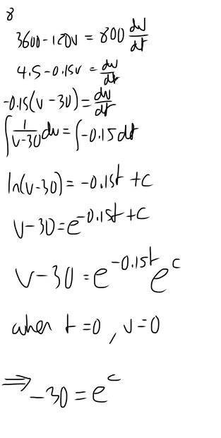

my attempt at a solution -I can not see how to rectify it as I don’t think I did anything wrong in the first steps. Thanks.
Does this work when t = 0 ?
Start with [itex]m\dot v = F - kv[/itex]. Do not subtitute values for [itex]m[/itex], [itex]k[/itex] and [itex]F[/itex] until the final step.
This is of the form [itex]\dot v + f(t)v = g(t)[/itex] which is easiest solved using an integrating factor, which in this case avoids obtaining [itex]\ln |v - 30| = ...[/itex] and having to work out whether [itex]v - 30[/itex] is positive or negative.

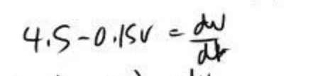

You don't need to solve the diff. eq. to answer the question.
What is the right-hand side of this equation when the car reaches max speed?

Integrating factors are your friend if you consider integrals as expressions describing an actual physical situation rather than a mathematical abstraction. In this particular case, we have to do two additions using dummy variables ##u## and ##\tau## to express velocity and time parameters:
1. ##\dfrac{du}{u-30}## from ##u = 0## to ##u=v## (forgive the mixed symbols and numbers).
2. ##-0.15~d\tau## from ##\tau = 0## to ##\tau=t.##
Then $$\int_0^v \frac{du}{u-30}=\int_0^t(-0.15)~d\tau~$$takes care of the integration constants automatically. BTW, I cannot think that the absolute value of the argument of a logarithm would ever be needed in an equation describing a physical situation.

Here is my answer: I copied the integral directly from OP's work exactly to make my point. The result of the integral is nonsense because the integrand is clearly negative which it cannot be because the car starts from rest and therefore has to move in the (positive) direction of the force.
Here is what I would do. As you suggested, I would write the equations in symbolic form to end up with $$\frac{dv}{F-kv}=\frac{1}{m}dt\implies \int_0^v \frac{du}{F-ku}=\frac{1}{m}\int_0^td\tau$$"Well", you might ask, "how do I know that the same problem will not arise in this symbolic form of the integrals?"
Answer: If you express the integration variable ##u## as a fraction of the terminal (maximum) velocity ##v_{\text{ter.}}##, it should be obvious that nothing horrible happens at any finite time ##t## and that as ##t\rightarrow\infty## the car reaches terminal velocity.
Why can't the integrand be negative? Since the car starts from rest and accelerates in the ##+x## direction, we would expect ##u-30<0## and ##du>0##.

But that's not the integrand @maxim07 derived, which is what you seemed to be referring to in post 8. For the same reasons you argued that your integrand should be positive, the OP's integrand should be negative. In other words, if the OP's integrand is nonsense, then so is yours.

I believe some people here are overcomplicating things. @maxim07 what you did is almost correct, you just should have put ##v-30## into absolute value from the fifth line and after. So your general solution should be $$|v-30|=e^{-0.15t}e^C$$.
You can apply the initial condition now and you ll get ##|0-30|=e^C## or ##e^C=30## which is the correct value for the constant term.
To be able to remove correctly the absolute value so you can recover ##v(t)=...## you have to take cases v>30 or v<30, and again rely on the initial condition to decide on which case the problem setup puts you.
Okay, so considering v<30 -you add 30 to both sides which gives v = 30(1 - e^-0.15t)
if v<30 then ##|v-30|=30-v##
