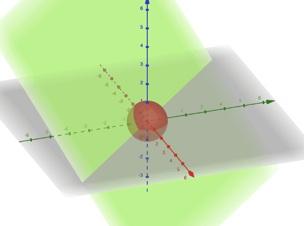

find the max of f=xyz on the domain bounded by the unit sphere in R3 and x+y+z=0
xyz
x^2 + y^2 + z^2 = 1
x+y+z=0
I tried parametrizing the domain using spherical coordinates, with theta and phi.
I also tried the method of lagrange multipliers, but the substitutions don't easily result in an easy solution. It requires solving five equations for five variables, and no easy way to isolate variables.
I think the hint is pointing at the fact the domain is a circle of radius 1 centered at the origin.
graph of the domain is the intersection of the green plane and the hollow red sphere.

I believe you are right, the domain is the intersection of the two sets. The graph shows the set of all points in a circle of radius 1, centered at the origin and tilted 45 degrees.

tilted 45 degrees.
No, it's something like arcsin(√(2/3)).
