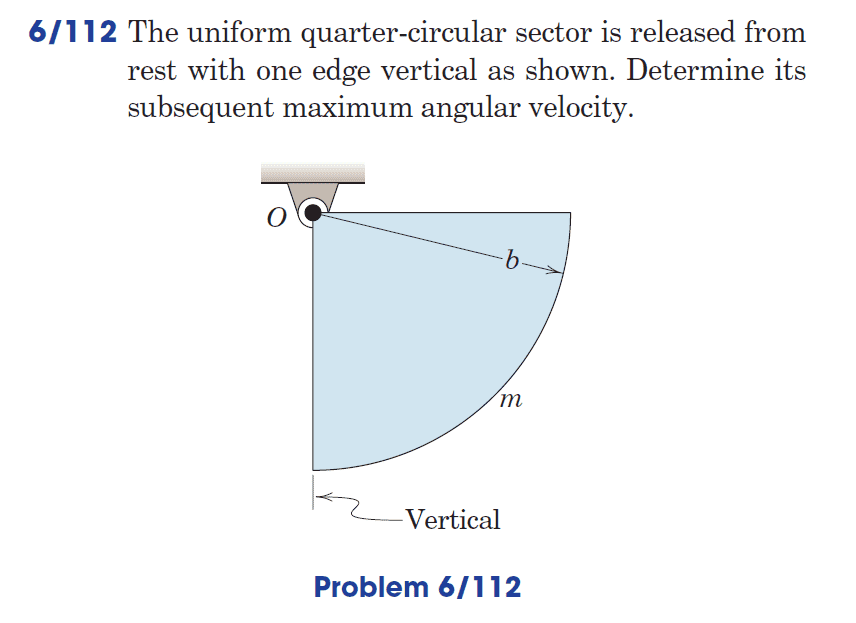

Finding the general formula for max angular velocity ( answers say 0.839*(g/b)) but I do not understand how
0.839*(g/b)
Diagram of a uniform quarter-circular sector pivoted at point O on a support, with radius b and mass m, one straight edge hanging vertically down and labeled Vertical.
  • Diagram of a uniform quarter-circular sector pivoted at point O on a support, with radius b and mass m, one straight edge hanging vertically down and labeled Vertical.

Regarding the potential energy... Does the whole semicircle fall a distance b?
The fall is any distance but here I assume when the part where 'm' is located is nearest to bottom that will be the max speed thus max angular velocity
What I was hinting at is the available PE cannot be mgb because the centre of mass cannot fall a distance "b".
Yes you are right and i did change the last one by editing the first post
