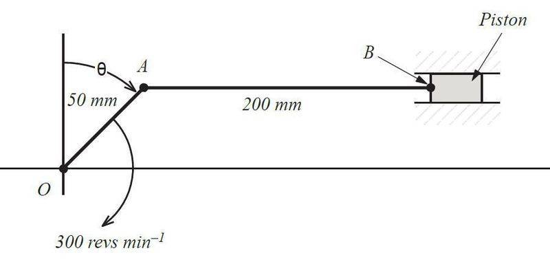

After happily working my way through the earlier parts of this question, I'm pretty much at the end of my tether with the last two parts. Please find the diagram attached:
A) Determine the value of the angle θ (measured from vertical) when the angular velocity of link AB a maximum.
B)
What is the maximum angular velocity of link AB.
Vao = 1.57m/s
Vab = 1.11m/s
Vbo = 1.11m/s
Aba(r) = 6.06m/s
Aoa(r) = 49.36m/s
Aba(t) = 35.1m/s
Abo = 41.4m/s
Angular Velocity of AB = Vab/Lab
Angular Velocity of AB = 1.11/0.2
Angular Velocity of AB = 5.5 rad/s
Angular Velocity of AO = 2πN/60
Angular Velocity of AO = 2π300/60
Angular Velocity of AO = 31.42 rad/s
I can't seem to find any relevant equations for finding the MAXIMUM angular velocity. Any help will be greatly appreciated, would like a nudge in the right direction so i can figure it all out. If it helps at all I've calculated the acceleration and velocities of each component.
I think, but I am not 100% sure, that maximum angular velocity occurs when the piston is at maximum/minimum displacement. Can anyone confirm this?
Cheers!

Apologies, I've attached a new image to this post which should hopefully work for you.

  • Mechanism diagram of a crank OA of 50 mm driving a connecting rod AB of 200 mm to a piston at B that slides horizontally; crank angle θ measured from the vertical and crank rotating at 300 revs per minute.

I think when acceleration equals zero angular velocity will be at a maximum.
Thank you, I'm pretty confident I've cracked it now :)
Wondering if anyone can add to this.
I want to derive a formula for angular acceleration so I can then work out the maximum angular velocity, but I'm not sure how to go about
