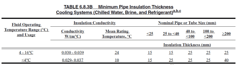

Mean Rating Temperature for insulation in ASHRAE
- Thread starter tj00343
- Start date
The mean rating temperature for insulation in ASHRAE fundamentals and standards 90.1 & 90.2 is crucial for determining the minimum insulation thickness for chilled water pipes. The footnote (a) provides a formula for calculating the minimum thickness (T) based on the actual outside radius (r), listed insulation thickness (t), conductivity of alternate materials (K), and the upper value of the conductivity range (k). Understanding this formula is essential for ensuring compliance with ASHRAE standards and optimizing insulation performance.
PREREQUISITES- Familiarity with ASHRAE standards 90.1 and 90.2
- Understanding of thermal conductivity and insulation materials
- Basic knowledge of fluid temperature effects on insulation
- Ability to interpret engineering formulas and calculations
- Research the specific insulation materials and their conductivity values as per ASHRAE guidelines
- Study the application of the formula T = r{(1 + t/r)K/k – 1} in real-world scenarios
- Explore the implications of insulation thickness on energy efficiency in chilled water systems
- Review case studies on compliance with ASHRAE standards in building projects
Engineers, architects, and HVAC professionals involved in building design and energy efficiency, particularly those working with chilled water systems and ASHRAE compliance.
