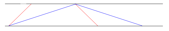

Measuring the "one way speed of light" is equivalent to solving one equation in two unknowns. No amount of Rube Goldebergery will change that.

  • #108
cmb said:
and if the delay is the same, would this not show light is isotropic in that axis, in those two tested directions?
It would show that the hypothetical anistropy affects light and the signal speed in the cable similarly.
  • #109
Dale said:
the details are irrelevant.
Right. Just like in a perpetual motion machine. You can tart it up all you like, but energy is still conserved.
