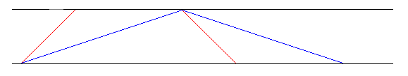

The diagrams in post #143 do not appear to represent what I have tried to illustrate in words. Maybe I am being completely opaque in words and a diagram might help?

You can add a diagram, but make sure you understand mine first.
This is a displacement-time graph of what I think you were describing. Time is left-to-right, displacement vertical. Velocity is the slope of a line. The two horses leave the start line at the same time. The red horse is going faster, so it gets to the finish line first. The experiment is shown twice, once starting from each end.
The only difference between this and the first diagram in #143 is that the red horse doesn't do the extra trips that prove that the difference in arrivals is invariant.

  • #162
Sure.
Now show the horses going 'to' the finish line both at x1.5 their 'normal' [isotropic] speed and on the return path x.5 their 'normal' speed, as if their 'normal speed' varied and they didn't realize it.
Average there and back is 'normal speed' for both horses, but the gap between the red and blue lines on the top line is smaller than the gap between red and blue on the lower line.

  • #164
Third diagram in #143 is the correct way to do that. And 1.5x speed and 0.5x speed averages to 0.75x speed, by the way.

  • #166
The third diagram does not show what I have said.
In the third diagram, the red horse runs at infinite speed. What is half of infinite speed? It's still infinite speed. So the red and blue lines going 'out' should both be vertical.
There is never an interval between red and blue horses passing the finish line.

  • #168
As noted in the post you quoted (although I edited the second sentence in, so you may not have seen), 1.5x speed and 0.5x speed averages to 0.75x speed. So your numbers would not work. Mine would. You can use a finite one-way speed if you like - as I noted in #143, all it does is shear the diagram.
