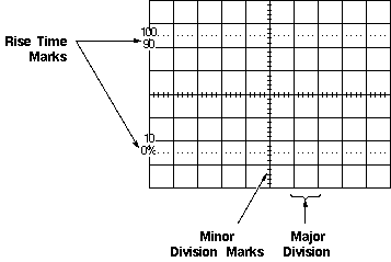

Older CRT oscilloscopes were calibrated with approximately one centimetre squares. Each of those was called a division. Those divisions were divided again by 10 to give approx 1 mm sub-divisions.
An error of half a subdivision means ±5% of the setting. So on the 2V/div range, the error is ±0.1 V.
There is usually a calibration signal test point on the CRO. Maybe a square-wave 1kHz, 0.1Vpp. Look at that to identify the calibration used for voltage and time.

In think that 5 minor divisions per centimeter is more common now. So that's what I'd guess the specification the OP is referring to means (although as pointed out, it would be good to have a link to the manual/datasheet the OP is referring to).
http://www.hobbyprojects.com/oscilloscope_tutorial/images/display_of_oscilloscope.gif
