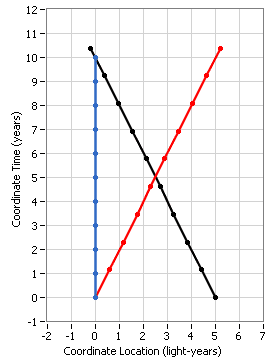

You can't travel at the speed of light so let's shelve this issue until later and then maybe you'll understand why.
pearmtn said:
A related situation would be if rather than moving forward at the speed of light you were moving forward at half the speed of light and passed an object moving half the speed of light in the opposite direction. Now your relative speed is the speed of light, but neither object is moving at the speed of light relative to some third object (e.g. the earth). I don't see why you couldn't continue to speed up so that your relative speed begins to exceed the speed of light.

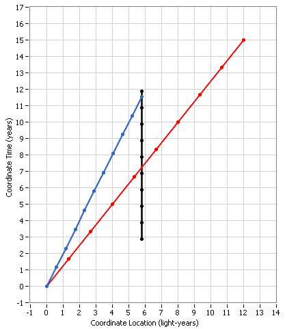

Your best way to understand situations like this is to draw the frame with its objects on a spacetime diagram and then use the Lorentz Transformation process to see what the same situation looks like for a different frame moving with respect to the original one.
Here's a diagram for your situation where Earth is shown in blue, you are shown in red traveling away from Earth at 0.5c and you fly past another object in black coming towards the Earth at -0.5c. Note that no speeds exceed c (or even one-half c). The dots represent one-year intervals of time for you and each object:
Now we want to see how fast you (in red) are going with respect to the black object so we transform to its speed of -0.5c:
As you can see, your speed in the rest frame of the black object is 0.8c, not 1c like you thought.
We could repeat this process as many times as you want and you'll never get to c. Hopefully, this answers the issue that I shelved earlier.

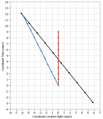

Every inertial frame limits everything to less than c except for light which travels at c in all inertial frames.
Here is a diagram for your red ship in which it is at rest:
Now you can see that the black object is traveling at -0.8c.
