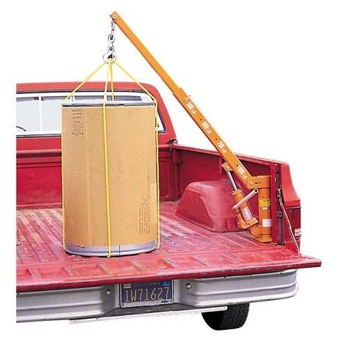

I bought this truck crane for my dad. I want to calculate the mechanical advantage of it.
http://www.harborfreight.com/1-2-half-ton-capacity-pickup-truck-crane-1647.html
I know how to calculate the mechanical advantage of a hydraulic jack and of a lever but I am not sure about where they connect to each other. When the jack lengthens it rotates back so the different angles change. How do i calculate that? Where do i start. Does it involve the law of cosines and calculus or something simpler?

edit: I know how to calculate that for the boom, ratio of the distances to the fulcrum and for the hydraulic jack ratio of the piston diameters. However where they connect there's changing nonperpendicular angles and linear and rotation motion so I am not sure how it works.
Do you mean you're trying to find the total mechanical advantage of the lever arm of the jack vs the arm of the boom? I'm not sure that's something you can calculate without knowing the properties of the jack pump and it may not even be constant if it depends on the weight of what you are lifting (I assume it is a pneumatic cylinder?).
Also, in terms of force, it varies with the angle of the boom.
The best you might be ablel to do is to start with the boom horizontal and pick up an object of known weight. Pump the handle of the jack a few times and measure how far the boom moved, then compare to the distance the end of the handle moves.
You'd have to know a lot to calculate it even roughly, like the PSI of the hydraulic system, accurate measurements of the angles and lengths of the arms etc...
i think it'd just be easier to take something you know is heavy, and attach it to the crane and see how much force it takes to life it up. That will give you a ratio which should be equivalent to what you want to know.

I bought the thing, I can easily take measurements of the exact different lengths. I bet relative lengths could be determined with only a picture though. I was more looking for the formula to use than the answer anyways. I don't think i would need to know the psi exactly, just the two different piston diameters. I though about putting a weight on the boom but wasnt sure how i would measure force on the handle, well i could buy a spring scale of some sort i guess It didnt occur to me till now i can put a smaller weights on the handle till it is more or less than the bigger weight on the boom.
I wanted to do the calculations though for the fun of it! Unfortunately i don't know how. I haven't got the crane mounted to the truck yet, i need a friend to do some welding because where i want to mount it on the bed there's no frame members directly underneath to bolt down through to. It takes a large number of pumps to raise the boom, probably an excessive number for the loads I am looking at . I thought about maybe modifying it to get the attachment point of the jack closer to the fulcrum so i would need less pumps. I also though about then moving the fulcrum pin up to increase the range of motion. It more likely i won't do that. I would just like to be able to do the calculations and have an understanding of how the angles and everything work.
