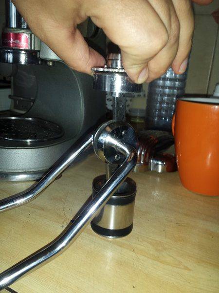

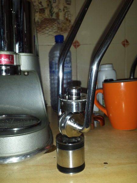

The application is a lever espresso machine.
I'll attach some pics
Photo of a chrome lever espresso machine with a long curved lever handle extended to the left, a water reservoir on top, and a grey base with a drip tray; a clear plastic water bottle and a foam container sit on the counter in front.
Close-up of a lever espresso machine mechanism: a curved chrome lever arm pivots on a joint above a stainless steel piston body with black rubber ring, beside a grey espresso machine and an orange mug.
Close-up of a hand lifting a chrome portafilter basket from a lever espresso machine, with the chrome lever arm curving across the foreground and an orange mug behind.

  • Photo of a chrome lever espresso machine with a long curved lever handle extended to the left, a water reservoir on top, and a grey base with a drip tray; a clear plastic water bottle and a foam container sit on the counter in front.
  • Close-up of a lever espresso machine mechanism: a curved chrome lever arm pivots on a joint above a stainless steel piston body with black rubber ring, beside a grey espresso machine and an orange mug.
  • Close-up of a hand lifting a chrome portafilter basket from a lever espresso machine, with the chrome lever arm curving across the foreground and an orange mug behind.

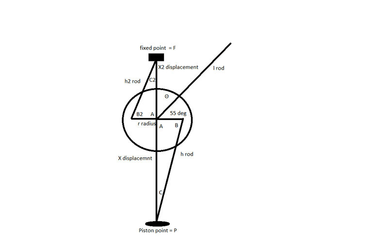

Schematic of a crank mechanism: a circle centred at A with radius r, a horizontal crank arm to B, rod h running from B down to the piston point P, rod h2 from B2 up to the fixed point F, and rod l angled up and to the right; labels include 55 deg and Θ.
Lever angle relationship to Crank Angle
Θ+55deg+A= 180 deg
If F is a vertical force applied on the end of rod l,
then CW torque on the crank is:
τ=F.l.sin(Θ)
at torque equilibrium
CCW torque from the upward force Fp from fixed point P along rod h to radius r, at an Angle B is:
τ1=Fp.r.sin(B)
and CCW torque from the downward force Ff from fixed point F along rod h2 to radius r, at an Angle B2 is:
τ2=Ff.r.sin(B2)
τ=τ1+τ2
Is t1=t2?
offering equal resistance to the crank turning CW?
Upward force from the piston F1=Fp.cos(C)
Downward force from Fixed point F2=Ff.cos(c2)
F.l.sin(Θ)=Fp.r.sin(B) + Ff.r.sin(B2)
F.l.sin(Θ)=F1.r.sin(B)/cos(C) + F2.r.sin(B2)/cos(C2)
Is this right?
How to proceed?
thanks
  • Schematic of a crank mechanism: a circle centred at A with radius r, a horizontal crank arm to B, rod h running from B down to the piston point P, rod h2 from B2 up to the fixed point F, and rod l angled up and to the right; labels include 55 deg and Θ.
powdernose said:
Is t1=t2?
No. But what is the relationship between the vertical force components F1 and F2?
Given the various lengths that you know, what is the relationship between angles A and B?
When I had plotted x and x2 from 0 deg - 180 deg using the crank position formula,
I then used the law of sines so that
sin(B)=(sin(A).x)/h
and sin(B2)=(sin(A).x2)/h2
Yesterday I used a protractor to get as precise as possible measurement of the angle relationship,
I was close, Θ+53deg+A= 180 deg
and the complete range is 135 deg

After that, instead of plotting x and x2 again,
I calculated angle C from the law of sines
sin(C)=(sin(A).r)/h
A+B+C=180 deg
So I have the angles B plotted through the range of motion.
powdernose said:
I have no idea.
Assume the disc is not accelerating. What are the forces on it?
powdernose said:
F1+F2= total vertical force on the piston P?
No. Compressions in series do not add.
powdernose said:
sin(B)=(sin(A).x)/h
Yes, but x varies too. Can you find a relationship between A and B which only brings in constants?
By the disk do you mean the crank? Or the piston disk?
I suppose it doesn't matter as they move downwards in unison.
Assuming equilibrium,
F=m. a
Acceleration =0 so net Force =0
The Lever rod l only creates torque,
So vertical component F1 must equal vertical component F2, for the crank to be stationary or to move with a constant velocity down the path (which it doesn't, mostly because the resistance provided the other side of the column of water is variable)
Shouldn't the horizontal components of the forces on the h and h2 rod also be equal?
Or are those compression forces?
I don't think I understand this, do you have a link I can read up on?
Well A, B and x are all variables. As is Θ.
Do you mean to solve to a single variable?
A+53+Θ=180
Α=127-Θ
A+B+C=180
B=180-A-C
B=53+Θ-C
From the law of sines as mentioned above
sin(C)=(sin(A).r)/h
So, arcsin[sin(C)] =arcsin[(sin(127-Θ).r)/h]
C=arcsin[(sin(127-Θ).r)/h]
B=53+Θ-arcsin[(sin(127-Θ).r)/h]
Similarly
B2=53+Θ-arcsin[(sin(127-Θ).r)/h2]
Yes.
No. The crank is constrained to move vertically, so there are horizontal forces from the sleeve that constrains it.
Yes.

So to continue:
τ=τ1+τ2
and F1=F2=Force applied Fa
F.l.sin(Θ)=Fa.r.sin(B)/cos(C) + Fa.r.sin(B2)/cos(C2)
F.l.sin(Θ)=Fa.r(sin(B)/cos(C) + sin(B2)/cos(C2))
M.Advantage =Fa/F=[l.sin(Θ)]/[r.(sin(B)/cos(C) + sin(B2)/cos(C2))]
C2=arcsin[(sin(127-Θ).r)/h2]
M.A=Fa/F=[l.sin(Θ)]/[r.(sin(53+Θ-arcsin[(sin(127-Θ).r)/h])/cos(arcsin[(sin(127-Θ).r)/h])+sin(53+Θ-arcsin[(sin(127-Θ).r)/h2])/cos(arcsin[(sin(127-Θ).r)/h2])]And just to check, as I've reached this far,

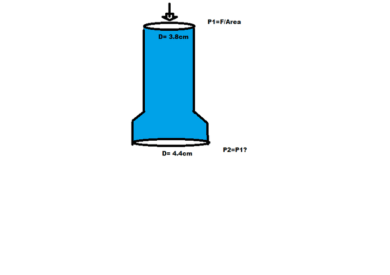

once the force is applied to the piston disk of D=3.8cm,
a pressure f/area is exerted on the column of water in the cylinder
Diagram of a blue fluid-filled vessel with a narrow upper section labelled D= 3.8cm and a wider base labelled D= 4.4cm, a downward arrow at the top labelled P1=F/Area and P2=P1? at the bottom.
At the bottom of the cylinder the diameter widens to D= 4.4cm,
but the pressure remains the same yes?
and F1/A1=F2/A2?
thanks
  • Diagram of a blue fluid-filled vessel with a narrow upper section labelled D= 3.8cm and a wider base labelled D= 4.4cm, a downward arrow at the top labelled P1=F/Area and P2=P1? at the bottom.
First, a correction
No, there is a linear force from the lever as well.

Okay, I think I see what you mean.
If I don't assume optimal operation with the force applied perpendicular to the lever, then I will have a linear force along the lever towards the crank,
and this force will have a vertical component,
which should be F3=cos^2(Θ).F
And so it would follow that
F1=F2+F3=Force applied Fa

I looked at the machine again and going back to post #5
in the first picture
one can see that the rod fits into a vertical slot, so its motion is constricted to the vertical, hence a horizontal 'sleeve' for the crankAny thoughts on the pressure?
and F1/A1=F2/A2?
Not sure what you are saying there. It looks to me that where the lever curves around to form the crank axle, and enters the cylinder, it passes through a pair of vertical plates. I would guess these plates can slide vertically in the wall of the cylinder. If so, that effectively constrains the axle against horizontal movement. Is that what you mean?
The cylinder is slotted. The vertical slots are cut into the cylinder. But yes, that is the effect.

I was asking more about the pressure in isolation,
forgetting a crank system,
say once a simple constant vertical force is applied to the piston disk of D=3.8cm,
and F1/A1=F2/A2?

maximum separation doesn't occur ever.
Recall I wrote in post #3:
haruspex said:
The limit of travel on the pistons will be when the two rods are in one straight line. That will be a bit before the lever is 35 degrees below the horizontal.
Your diagram shows the lever at 55 above horizontal and the rod attachment points on the same level. You also said that the low point of the lever is 45 degrees below horizontal, so that is a rotation by 100 degrees from the diagram position.
After rotating by 90 degrees the attachments points will be in a vertical line. That is beyond the point where the distance between the pistons is at a maximum.
So is the 45 degrees below statement wrong?
(Btw, the rods are never in a straight line because the crank disk is nearer to one piston than the other.)
and F1/A1=F2/A2?
Yes.
Yes, I believe I said you were right in post #5,
While my estimation of 55 deg was close, because I was looking at the effort arm,
when looking at the bottom position I initially, absent minded, looked at the shorter side of the V bar.
I did use a protractor later to get better estimations,
for which A+53+Θ=180
and estimated the full range of motion for Θ to be from -18 deg down to 117 deg.
Co-linearity would occur at Θ=127.

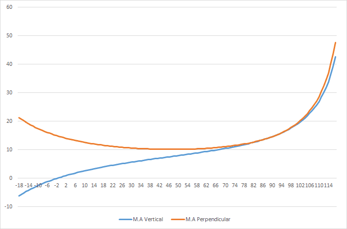

And for a constant perpendicular force applied on the lever, similarly it follows that:
F.l=F1.r.sin(B)/cos(C) + (F1-Fsin(Θ)).r.sin(B2)/cos(C2)
F1/F=(l+r.sin(Θ).sin(B2)/cos(C2))/r.(sin(B)/cos(C) + sin(B2)/cos(C2))
M.A Perpendicular=Fa/F=[l+r.sin(Θ).sin(53+Θ-arcsin[(sin(127-Θ).r)/h2])/cos(arcsin[(sin(127-Θ).r)/h2])]/[r.(sin(53+Θ-arcsin[(sin(127-Θ).r)/h])/cos(arcsin[(sin(127-Θ).r)/h])+sin(53+Θ-arcsin[(sin(127-Θ).r)/h2])/cos(arcsin[(sin(127-Θ).r)/h2])]
I then plotted the M.A through the range of motion
Line graph of two mechanical advantage curves against angle theta from -18 to about 117 degrees; blue 'M.A Vertical' rises from below 0 to about 42, orange 'M.A Perpendicular' falls from about 21 to about 10, flattens near 10 between 34 and 58, then rises steeply to about 48.
does that seem right?
haruspex said:
The weight, yes, but you can just add this to the linear force and torque from F as appropriate.
But then I lose the M.A as a function of Theta, right?
because by adding just the weight of the lever F4:
F.l.sin(Θ) + F4.l/2=F1.r.sin(B)/cos(C) + (F1-F-F4).r.sin(B2)/cos(C2)
F1=(F(l.sin(Θ)+r.sin(B2)/cos(C2)) + F4.(r.sin(B2)/cos(C2) - l/2))/r.(sin(B)/cos(C) + sin(B2)/cos(C2))
So there is a Theta dependent constant from F4 always offsetting the Mechanical advantage?

I just realized I had been misled by your original diagram when I wrote this:
You had shown the rods as verical there, so the ponts of attachment to the pistons were not central. Seeing the correction in post #6, I am now happy that the rod colinearity coincides with verticality.
powdernose said:
down to 117 deg.
Yes, but that's 27 below horizontal, a long way short of 45. It's the 45 that implied the pistons would reach, and return from, maximum separation.
Yes.
Yes, I'm sorry about the initial mistake with the angles,
I tried to edit the post when I sorted the angles out, but I couldn't edit the post by then.

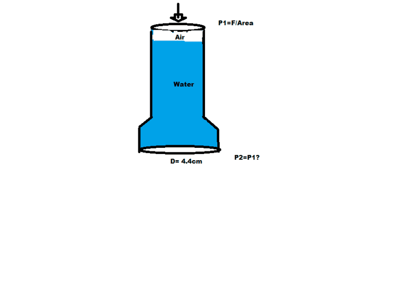

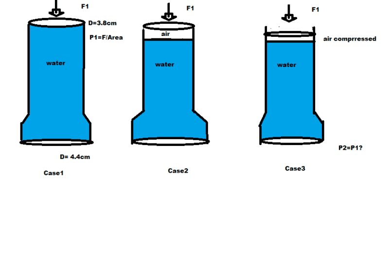

I did have a question I thought of,
going back to the piston pressure and forgetting the mechanism providing the force:
Diagram of a vertical cylinder with air above water, a downward force arrow and P1=F/Area at the top, a wider base labelled D=4.4cm and P2=P1? at the bottom.
If air is caught in the cylinder at the top,
how does that affect the pressure P2?
Is part of the pressure P1 dissipated in compressing the air bubble?
I tried searching for some help with this type of situation but coulnd't find anything.
thanks
  • Diagram of a vertical cylinder with air above water, a downward force arrow and P1=F/Area at the top, a wider base labelled D=4.4cm and P2=P1? at the bottom.
It depends exactly what you mean by that. For a given movement of the arm, less force is required, so less pressure is created. But for a given force applied, the pressure is the same - it just requires the arm to be moved further.

I'm not sure I follow.
I think it would be easier for me to understand taking the cylinder pressure in isolation.
Three cases of a water-filled hydraulic cylinder with a narrow top and wide base, F1 pushing down on the top piston; case 2 shows an air layer trapped above the water and case 3 shows the air compressed, with labels D=3.8cm, D=4.4cm and P2=P1?
F1 applied to the piston (3.8cm) on top of a column of water, applies pressure P1,
For equilibrium at the bottom (4.4cm) must have a pressure P2
P1=P2 in case1 and case3 only?
The pressure at the top must compress the air fully before equilibrium can be achieved?
I don't understand how it works with water and air mixed in the cylinder.
No, they are equal in all cases.
The difference is that with air present the piston will have to move further to achieve the same pressure.
