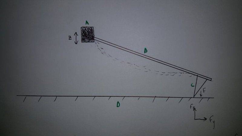

To give a bit of context, I am doing my final year university project on micro-mechanical interactions between an AFM probe and a sample surface. I do not have notes for a system this complicated, as we always considered our systems to be rigid bodies. I was always relatively clueless at mechanics so this particular small part of my project is a nightmare for me!
I have labelled the Free Body Diagram attached, but the following information should help to explain further:
Section A has a downwards-vertical displacement being applied, and can be considered a rigid body, fixed in all other DOFs.
A key feature of this system is the bending cantilever beam (Section B as marked in FBD).
It begins with an angle of 13 degrees from the horizontal axis, the inclined beam can be seen on the image FBD.
Section C (probe tip) can also be assumed to be a rigid body.
Section D is the sample surface which can be assumed rigid and fixed in all DOFs.
How do I get to the solution for finding Fz/Fy components and moments on the sample surface from the probe tip?
I have not given values for the system because I want to use the help provided to work through it myself.
I know there are moments relating to a bending with a stiffness. Not used to a system where a displacement is producing the force vector on the other end of the system.
As I say, this is a relative nightmare for me and I don't really know where to start, so all help will be greatly appreciated.
I'm sure I'll need to provide more information to helpers, so these will be answered in EDITS below.

Hi Nidum, thanks for your quick reply.
Yes, the AFM probe is being used in that manner. For this stage of the project, I am wanting to assume initial contact between probe/surface on an assumed-flat surface to see the force components and moments which are acting at the point of contact.
To answer your question simply: the beam is inclined at 13 degrees from the hoizontal for the inspection process.
I think I may have to consider the support at the probe tip as Pinned, and I'm not sure what, if any, to consider as the support for Section A? It is fixed in all DOFs apart from the z-direction.

The beam itself can be analysed by standard methods .
Problem is deciding what the conditions of loading and possible fixation at the probe tip are .
There are at least two different basic cases - static and dynamic .
For the static case I think that you could reasonably assume a simple vertical reaction load and no fixation .
To make a more informed decision you need to look at the physics and decide whether the tip digs into the sample surface enough to stop it sliding .
For the dynamic case the situation is more difficult to define but basically comes down to getting answers to questions :
(a) Is there any significant drag force as the tip is traversed across the sample ?
(b) Is the motion stable ?

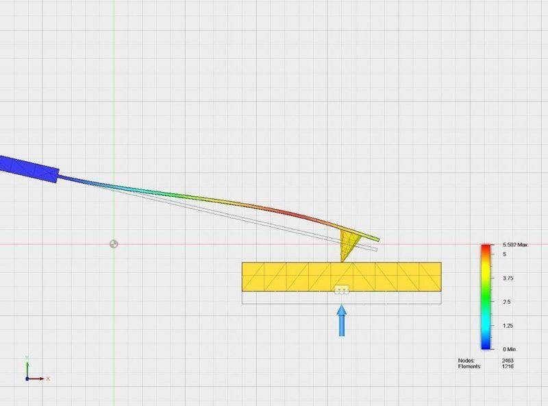

All we actually have to analyse is a simple mechanism the same as an old type gramophone pickup .
Back soon .
Whoever chose that 13 deg angle either knew what they were doing or they got lucky - with that angle the deflected shape is almost the same for both pinned and sliding cases at the probe tip .
Is seeing the deflected shape enough for now or do you want to start exploring deflection v load calculations ?

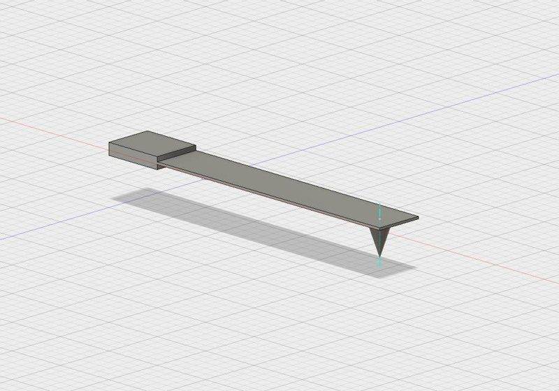

Hi Nidum,
That's very interesting! I am modelling the AFM in Abaqus FEA software but I'm a complete beginner so it's taken me 3 weeks to create the model! Can I ask:
1. Did you apply the displacement to the whole of Section A?
2. Did you make the Section A as a rigid body?
3. What material property in your model defines the stiffness of the beam? (I believe the answer to this would be Young's modulus, but let me know)
I want this thread to discuss the mathematical side of this problem but I'm interested in those ^ question for the FEA. See my next reply regarding your question in your follow-up post.
