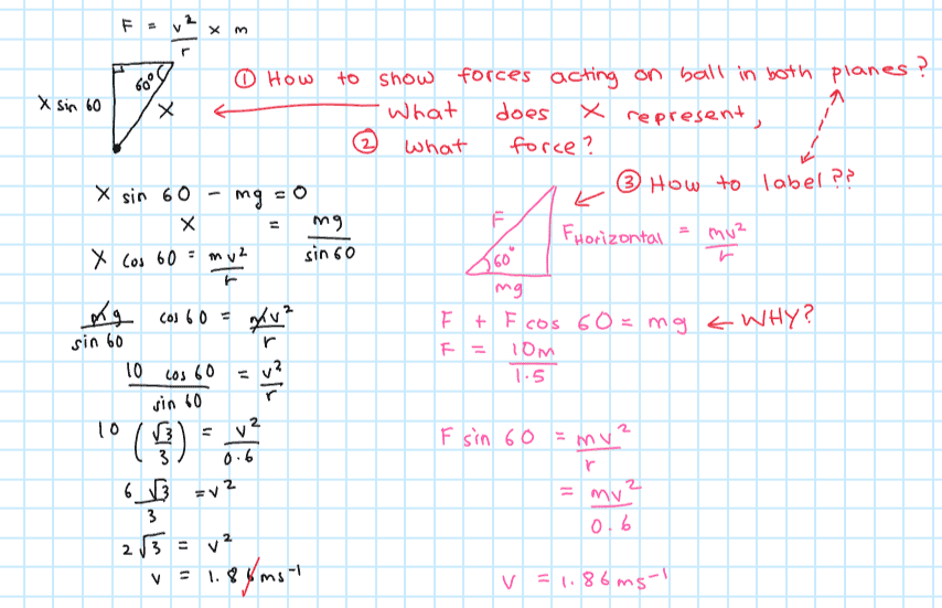

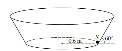

Q : A small sphere S of mass m kg is moving inside a smooth hollow bowl whose axis is vertical and whose sloping side is inclined at 60◦ to the horizontal. S moves with constant speed in a horizontal circle of radius 0.6 m (attached diagram 1). S is in contact with both the plane base and the sloping side of the bowl (attached diagram 2).
(i) Given that the magnitudes of the forces exerted on S by the base and sloping side of the bowl are equal, calculate the speed of S.
(ii) Given instead that S is on the point of losing contact with one of the surfaces, find the angular
speed of S
a = v^2/r OR rw^2
F=ma
As I attempted this question I was very confused and felt my understanding of the topic is unclear and has many gaps. For both parts, I approached the question as I knew the steps I had to do to get the answer but had very little understanding as to why. I managed to get the correct answer for both parts but after looking at the mark scheme felt that my method was off.
If anyone could please help me understand the following questions I would appreciate it very much! Thank you!
Part (i)
Handwritten working on grid paper for a conical pendulum problem: a triangle labelled X sin 60 and 60 degrees, equations X sin 60 minus mg = 0 and X cos 60 = mv squared over r, then 10 cos 60 over sin 60 = v squared over r, ending with v = 1.86 m/s, plus red annotations and a force triangle labelled F, mg and F horizontal.
*Pink represents mark scheme method

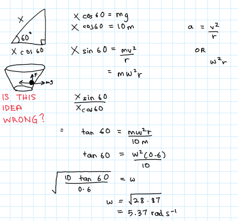

Part 2
Handwritten working on a conical pendulum: a sketch of a cone with a mass on its inner wall, labelled F, mg and an angle of 60 degrees, with the equations X cos 60 = mg and X sin 60 = mv^2/r, leading to tan 60 = w^2(0.6)/10 and w = 5.37 rad/s.
However I am still confused on the diagram.
  • Diagram of a conical funnel with a small ball S on its inner surface, the horizontal circular path of radius 0.6 m marked from the centre, and the wall making a 60° angle with the horizontal.

In your "why is this wrong" diagram, you seem to have the force ##mg## coming out of the side of the bowl?
A couple of questions:
How many forces are acting on the sphere?
What does "smooth" tell you about the contact forces between the sphere and the bowl?
What is the condition for uniform circular motion (of a given speed and radius)?
