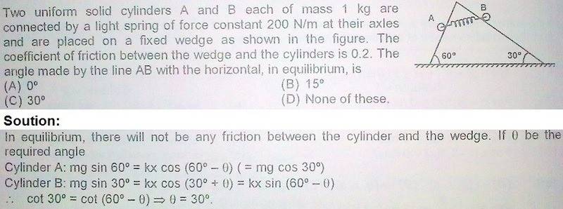

Why there won't be any friction?

hi cupid.callin! :smile:
hint: take moments about the centre of the cylinder :wink:
Friction is a reaction force, if the spring is there then there would be no need for it (possibly?)
i just need to know why solution says there will be no friction
shouldn't there be both friction and spring force and friction?
yes, take moments about the centre of the cylinder, and you'll find out!
