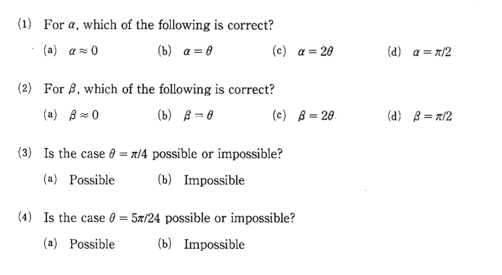

1. Homework Statement
Here this is a problem that I get troubled from MEXT scholarship examination.
And the problem is
F = mg
Fx = cosa
Fy = sina
Is anyone can help me to solve the problem. I read but I don't know what to start. Thank you.

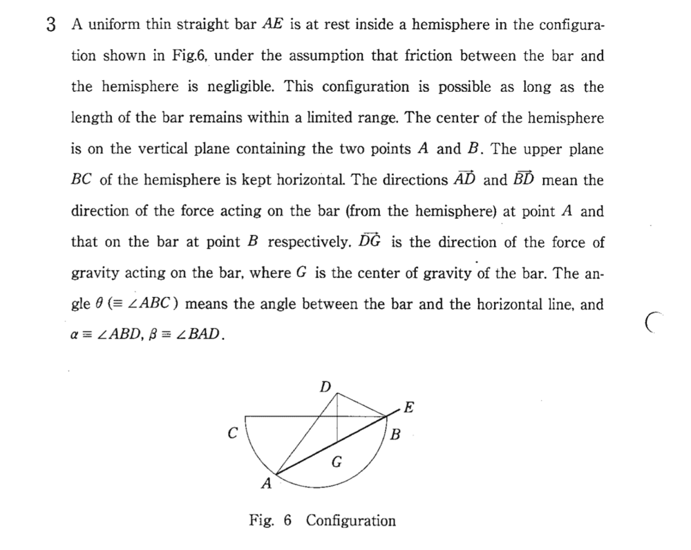

First thing is to check whether the diagram looks reasonable. What should be the relationships between the positions of A, B, D, E and G?
Now, I don't know how to find that relationship rather than mathematics.
First, what is the relationship between A, G and E?
Next, what do the lines AD, BD and DG represent? Why are they shown meeting at a point (D)?
What is the angle ABD? (Very different from what it looks in the diagram.)
A, G and E is in the same line.
AD, BD, and DG represent force perpendicular to the hemisphere.
I don't know the next.
There's more to it than that. What does point G represent?
AD and BD represent normal forces, and yes, AD is perpendicular to the hemisphere, but what should BD's direction be?
Given the meaning of G, what force does DG represent?
Why must these three forces pass through a single point?

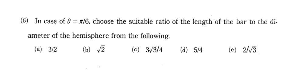

OK, Now I drew a diagram and solve problem number 1 and 2 already, I know that a is pi/2 and b is theta. But in problems number 3,4, and 5 I still don't know whether it is possible or impossible.
3 can be answered very easily, but might as well proceed straight to the general case.
Write out the usual horizontal and vertical force balance equations, and a moments equation for some suitable axis.
