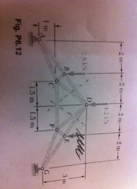

Mechanics question, structure with unknown forces

Find force between all members.
torque=force x distance
to use sections as seen in the photo, beyond that no idea how to attempt it. It would helpful if anyone could show me how to get the force out of even 1 member.
Start by finding ALL external forces in the system, then go onto using them to find the internal forces i.e the forces in the members.
using sections though, there seems to be no place to start

A and G have reaction forces due to the external forces being applied to the truss. Take moments about point A or G and solve for Ay or Gy by applying the concept of equilibrium. Once you've got one, you can find the other by using the concept of equilibrium in the Y direction.
That is your starting point.
