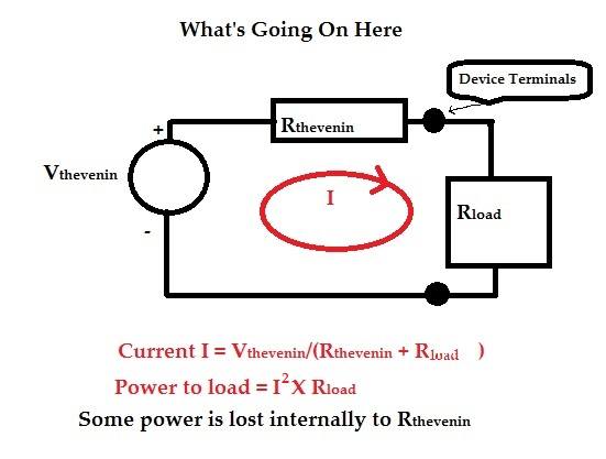

You need to focus on what's actually going on. Skeptic gave a hint, i'll try to add some detail to his hint. Then you'll appreciate Tom.G's suggestion.
In EE there is a theorem, "Transfer of power is maximum when impedance of load equals impedance of source". (for DC that is)
There's another theorem , "Any circuit can be represented by an ideal voltage source in series with an impedance." That representation is called "Thevenin Equivalent Circuit".
To find the Thevenin equivalent for a DC circuit you gather two measurements:
1. Measure open circuit voltage, write that number down as Vthevenin
2. Measure short circuit current
Then you divide result of (1) by result of (2) and write that number down as Rthevenin
Then you draw a circuit with a battery of voltage Vthevenin in series with a resistor of value Rthevenin .
That is the "Thevenin Equivalent Circuit". It will behave like the device under test. Well, so long as things stay simple ie neither Rthevenin nor Vthevenin is dependent on the other.
Tom.G's instructions tell you how to find "Thevenin Equivalent Circuit" for your modules. You should do it once for each one.
Now to maximum power transfer, as mentioned by skeptic :
When Rload is zero, obviously Rthevenin gets all the power.
With some algebra you could solve for power to load as f(Rload , Vthevenin and Rthevenin ).
Nowadays folks use spreadsheets to demonstrate.
You'll find efficiency is only 50% at point of max power transfer so most machines we don't run that heavily loaded. Radio antennas we do, though, to optimize signal transfer.
Anyhow, finding the Thevenin equivalent for your peltiers will give you an idea of the power available to a load. Then you could check how close to an ideal Thevenin circuit is each peltier gizmo by connecting a couple different Rload's to it and plotting results. Try 1X, ½X and 2X Rthevenin.
Chances are you'll find it somewhat nonlinear .
You can fit any three data points with a quadratic curve, and a least squares quadratic fit to four or five would make a nice slide for a presentation ...
you could teach beginners the interplay between internal resistance , power transfer and efficiency .
